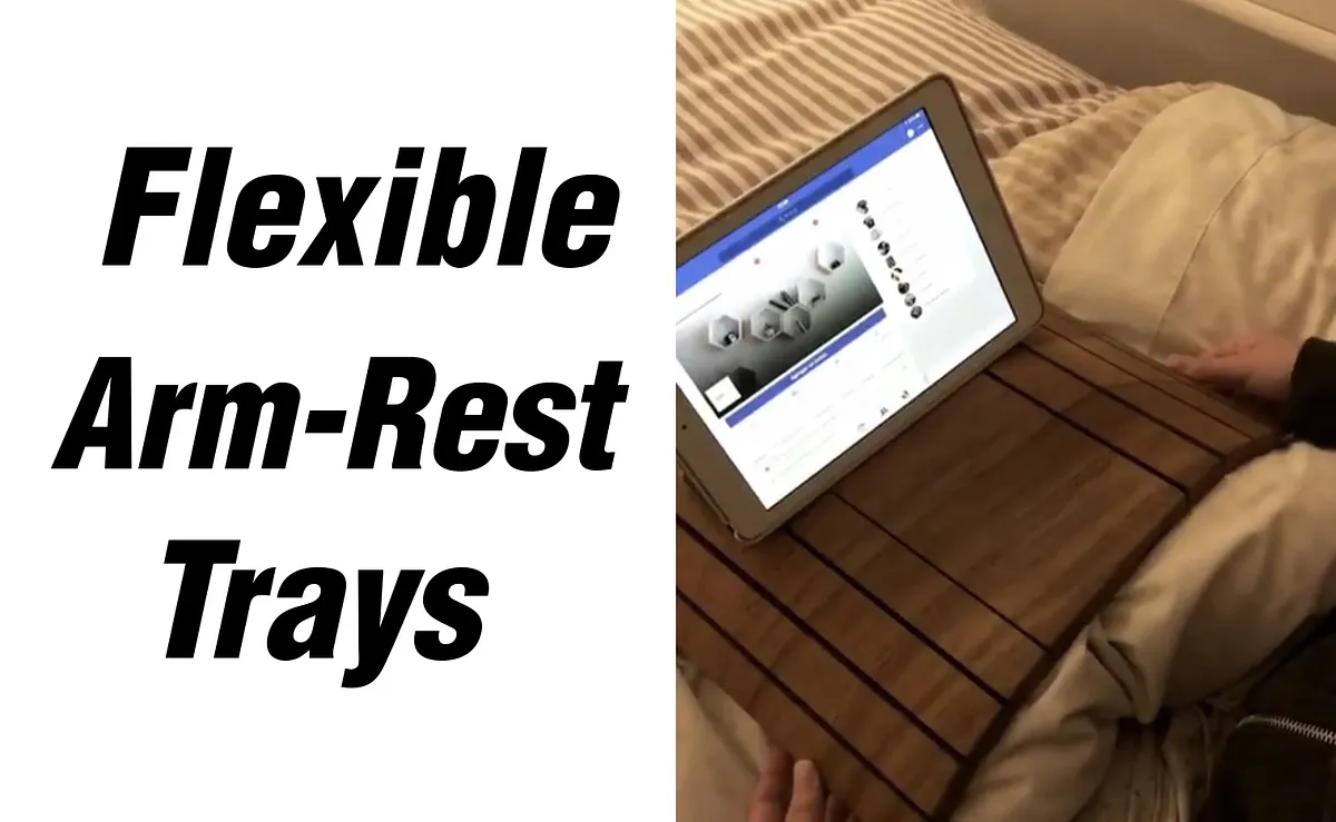

Select material
You need to pick a piece of material which is bigger than 270 x 400 mm in order for the piece to be able to be cut from it. The piece I chose for this project was 1/2 inch thick.
Estimated time: 5 minutes
Carving
Set your piece up, open the easel file and let it carve.
Estimated time: 40 minutes
Sanding and Finish
Sand all the pieces and apply your finish of choice. In this case I went for some Danish Oil, for a beautiful and easy finish.
Glue Bottom Support
Once the parts of the project are carved, grab a strip of any kind of fabric and glue it across the bottom side of all the pieces, making it the support that will hold the piece together.
