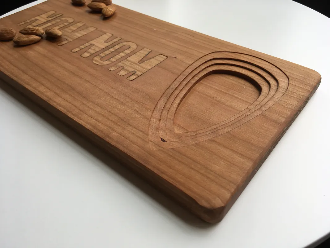

Carve!
The depth of your cut will impact how long it takes to carve your project. Mine took around 30 minutes to cut both workpieces (the board and the inlay cutout).
Estimated time: 30 minutes

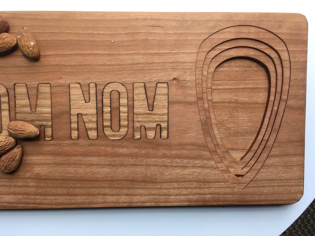

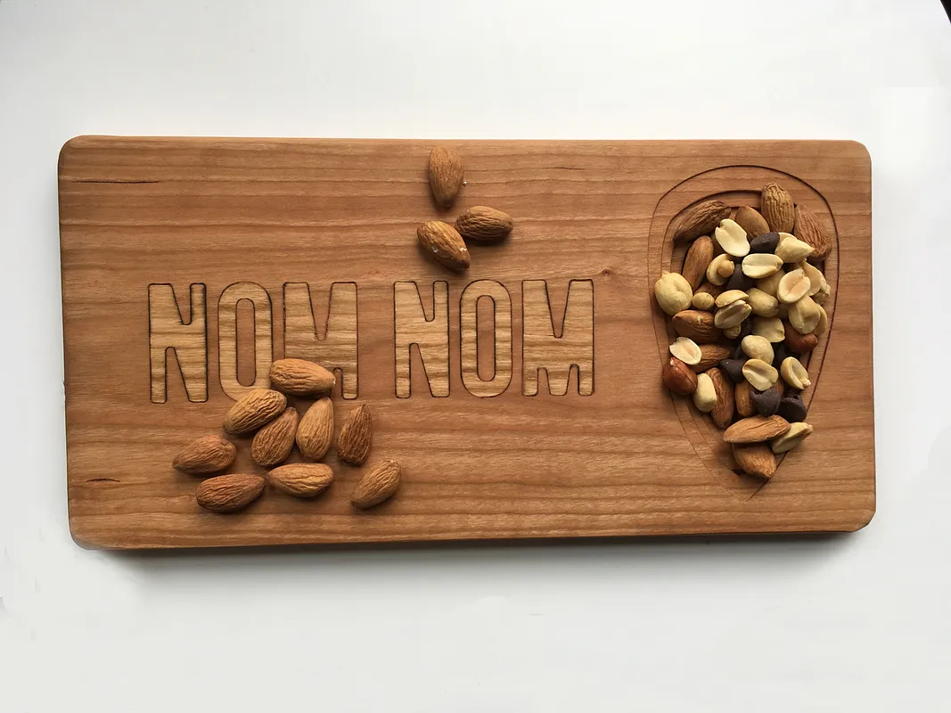

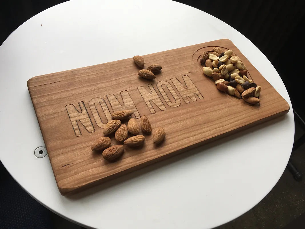

Install inlay and finish
Gently insert the inlay into the pocket. Using a piece of scrap material helps make weight distribution better for setting the inlay into the pocket.
I used mineral oil to finish this board. The cherry-on-cherry colors were much more prominent that way!
