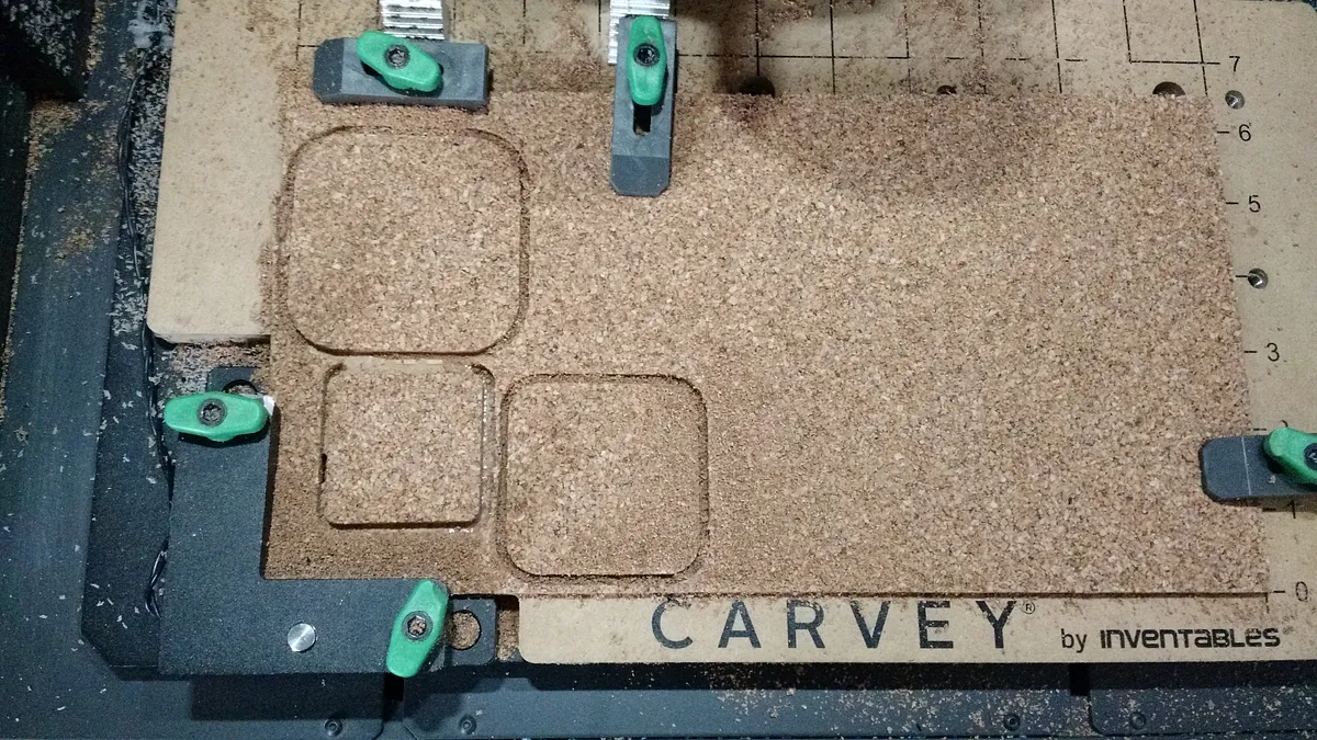

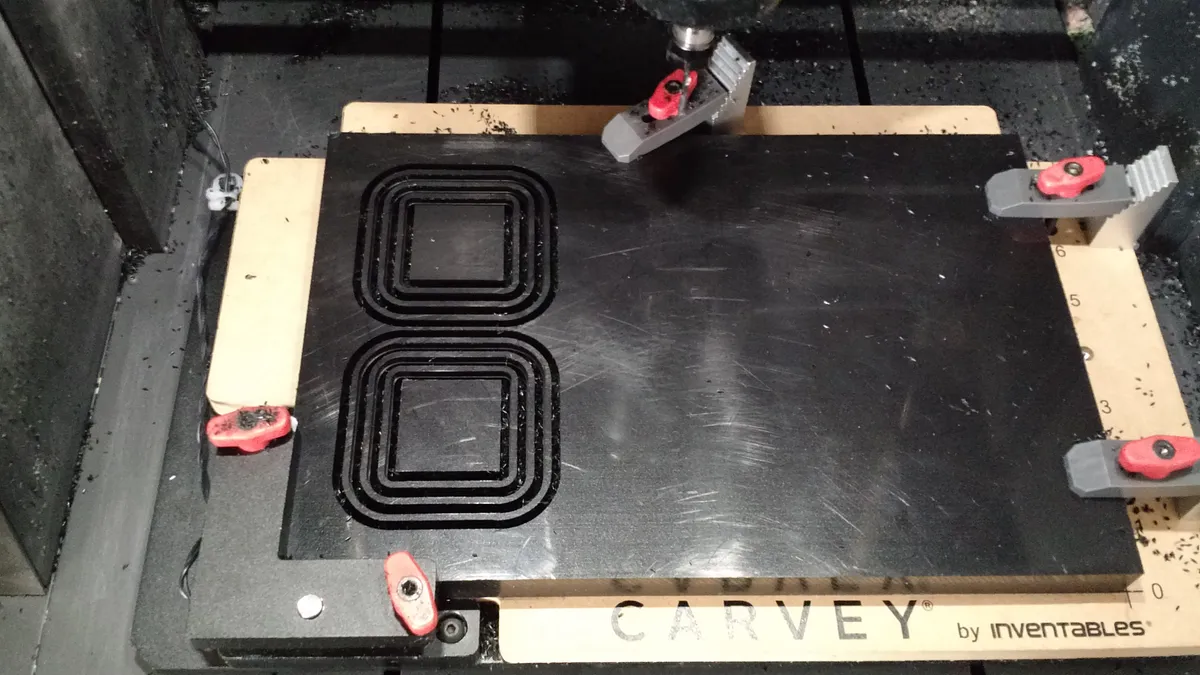

Mill box walls

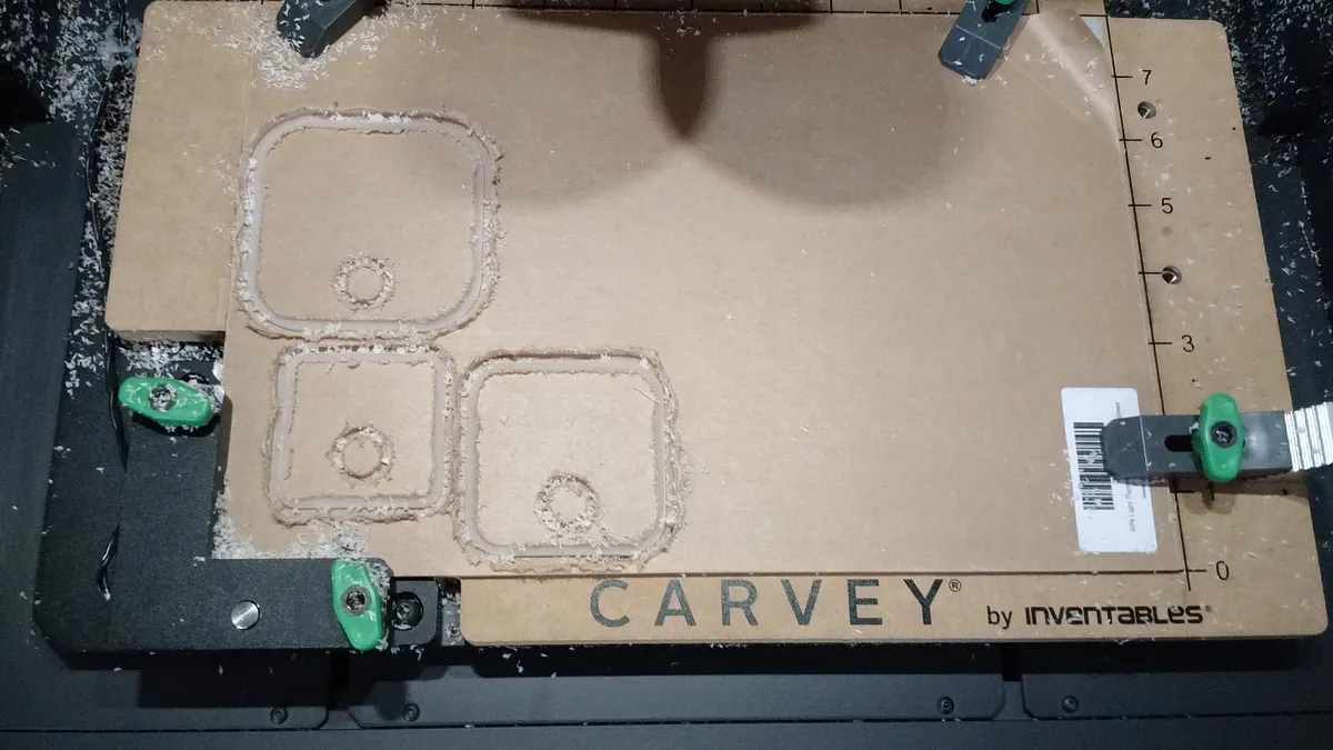

Use a 1/8" square or fishtail endmill to mill the walls for the box set. A 3/4" or taller material will be best for making a functional box. Use double sided tape to keep the nesting sections from shifting
Use this EASEL "link":http://easel.inventables.com/projects/lAJaBMX0xuvjf2M53-PReA
Stacking Boxes — Mill box walls

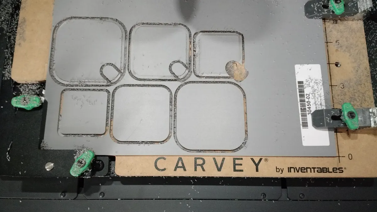

Mill box lids

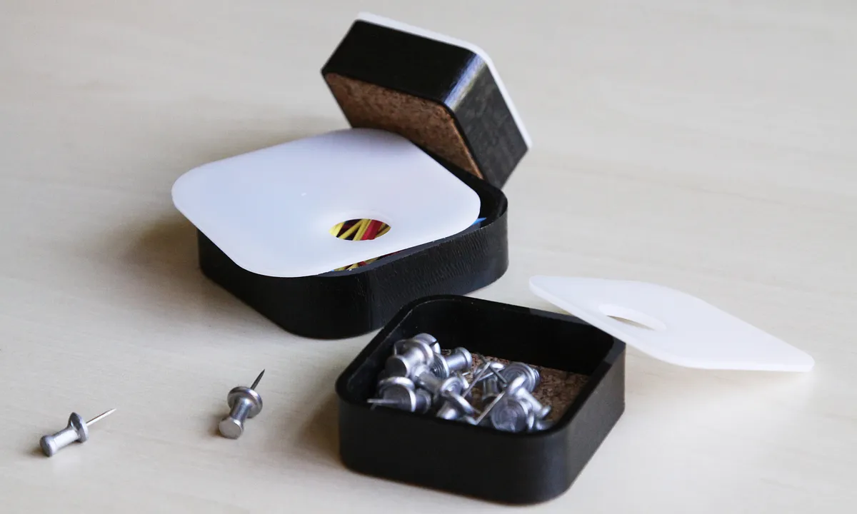

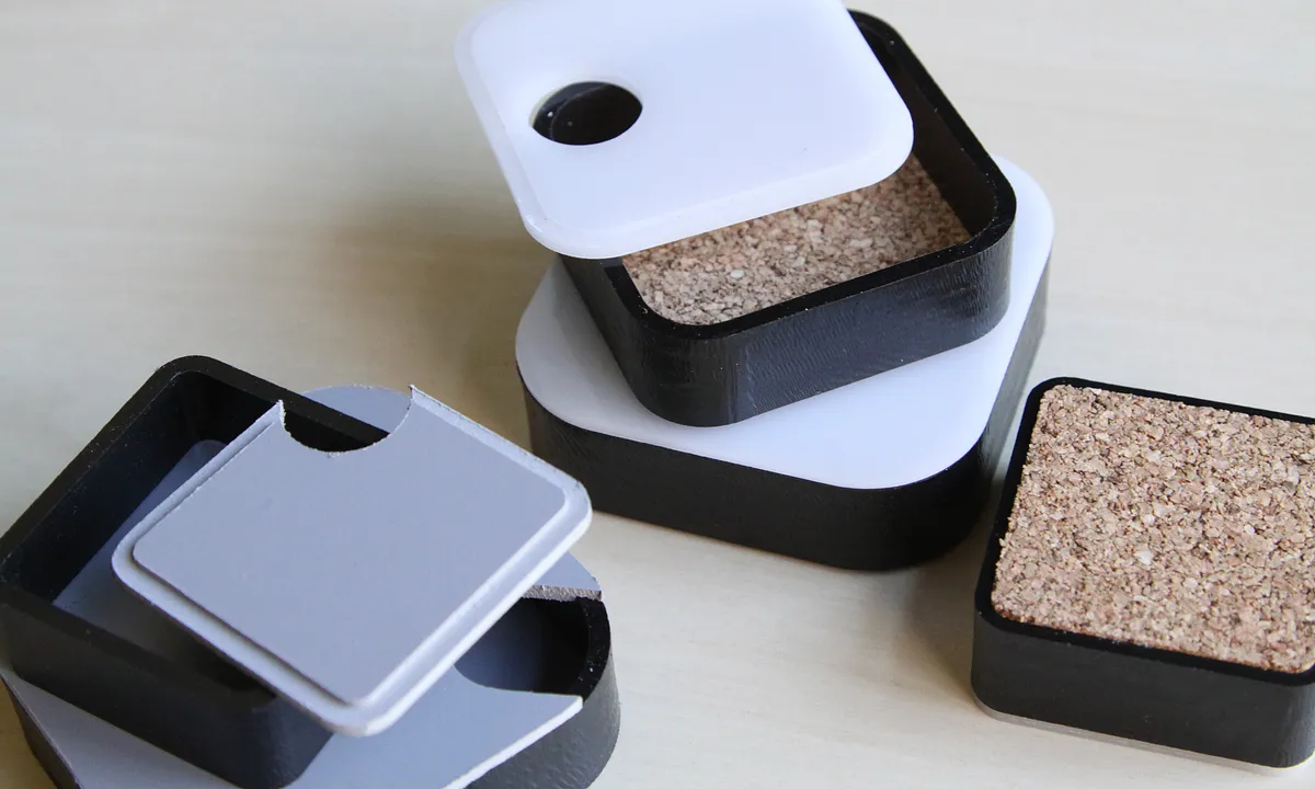

Choose a 1/8" material to use as your lid. Expanded PVC cuts quickly and comes in good colors. A translucent acrylic also works really well.
Use this EASEL "link":http://easel.inventables.com/projects/-3sWlerWnAfqJaCXaHZZyA
Stacking Boxes — Mill box lids
Stacking Boxes — Mill box lids (image 2)

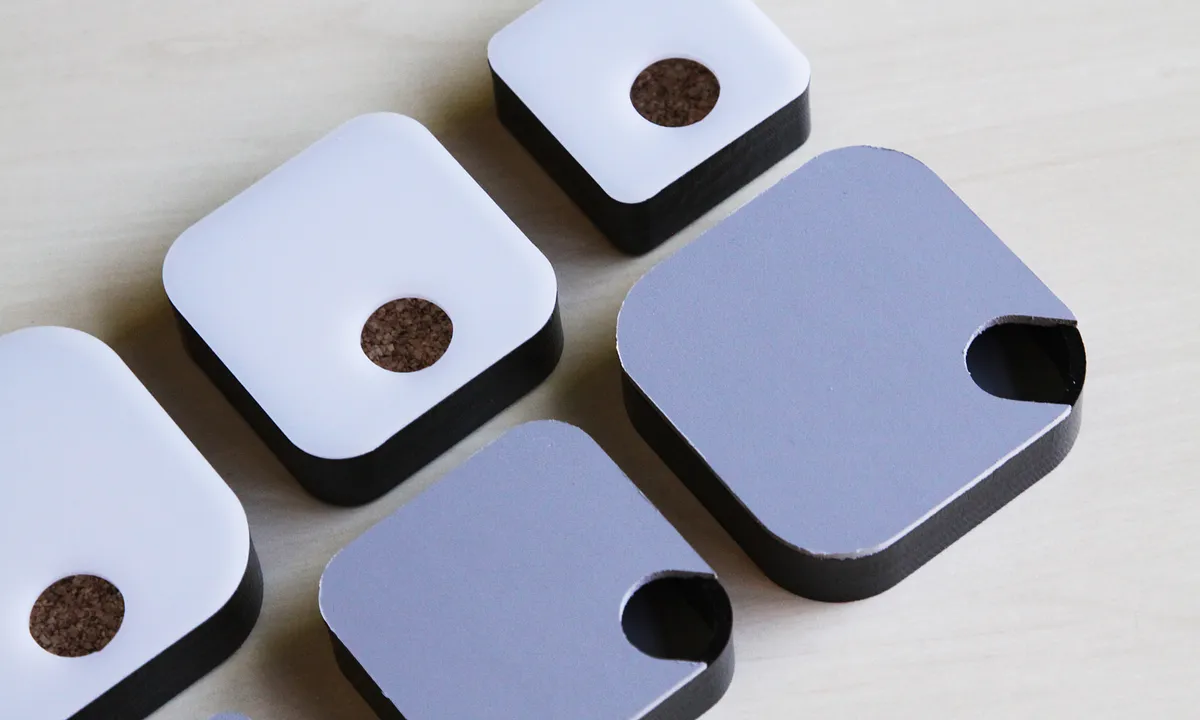

Mill box bases

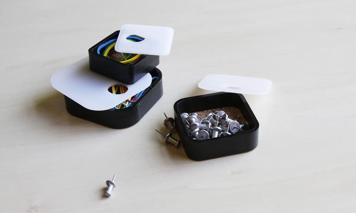

Mill the box floors from either the same material as the top, or choose one that compliments it well.
Use this EASEL "link":http://easel.inventables.com/projects/EEZ58NPFcOvP_Rs9rixjzw
Stacking Boxes — Mill box bases

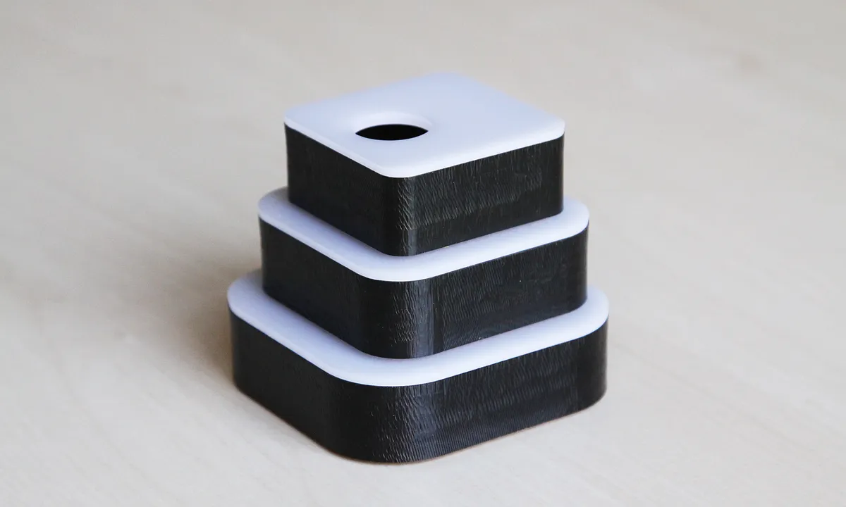

Assembly
If everything cuts correctly, no glue is required for assembly. The base fits into the side with the small ledge cut into it. For extra durability you can squeeze a small amount of super glue into this area.
