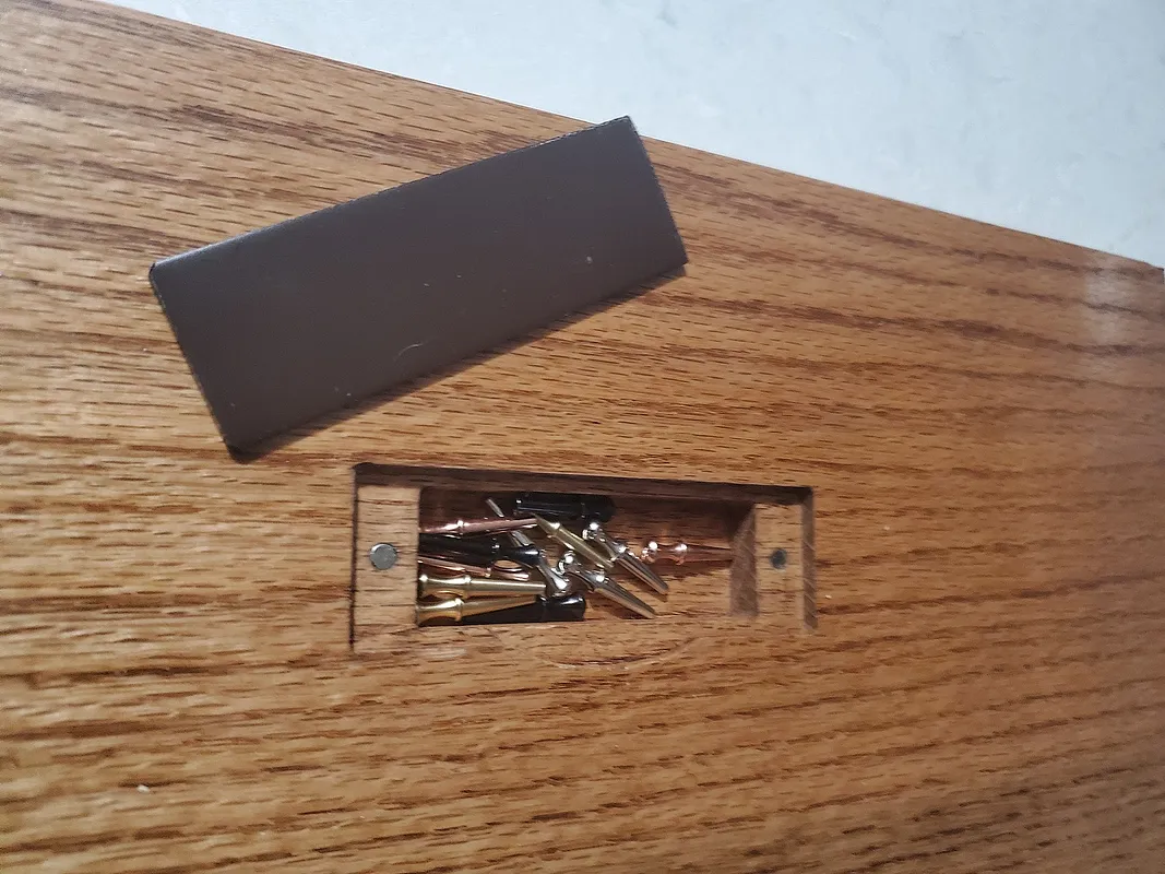

I used this design to hold the pegs in the back of cribbage board. Use 2 3/16 magnets to hold a 4" x 1 1/4 (12 gauge) metal plate to secure the pegs in the storage area.

For a smoother surface in bottom of pocket, change cut setting to rastor (cutting with grain of wood).
