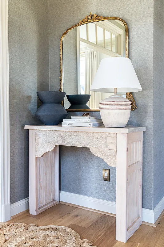

I wanted a show-stopping piece of furniture for our foyer and have long admired the intricacy and craftsmanship of Balinese hand-carved wood furniture. This is my take on a Balinese-inspired console table. Grab the plans and watch our video on JenWoodhouse.com to see how it all came together!
x-carve pro
Soft Maple

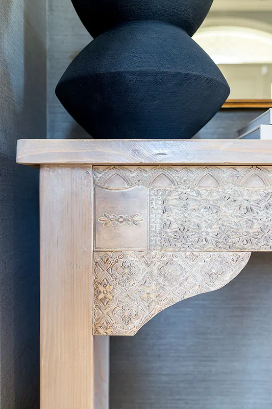

I have to ask. How many hours and what bits did you use for that It is beautiful.
Dennis ShermanPro · December 29, 2020
Dennis Sherman 1/8 v-bit and for both files according to easel details it takes about 2hrs and 7 minutes for the one carve, and 5hrs and 55 minutes for the second carve.

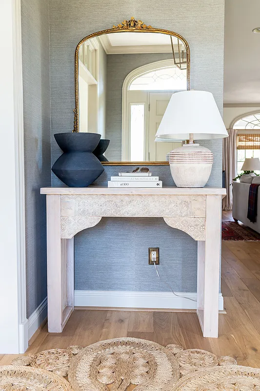

Is this stained or painted? What did you use to achieve this look? Looks great.
