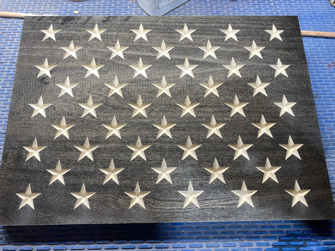

This union is sized for a 37" wide by 19.5" tall American Flag with 1.5" stripes (standard precut material many use). I use a 90* V bit at .25" depth. This file will give you the proper spacing appearance. Ensure your board is completely flat and held down evenly to achieve excellent results.
