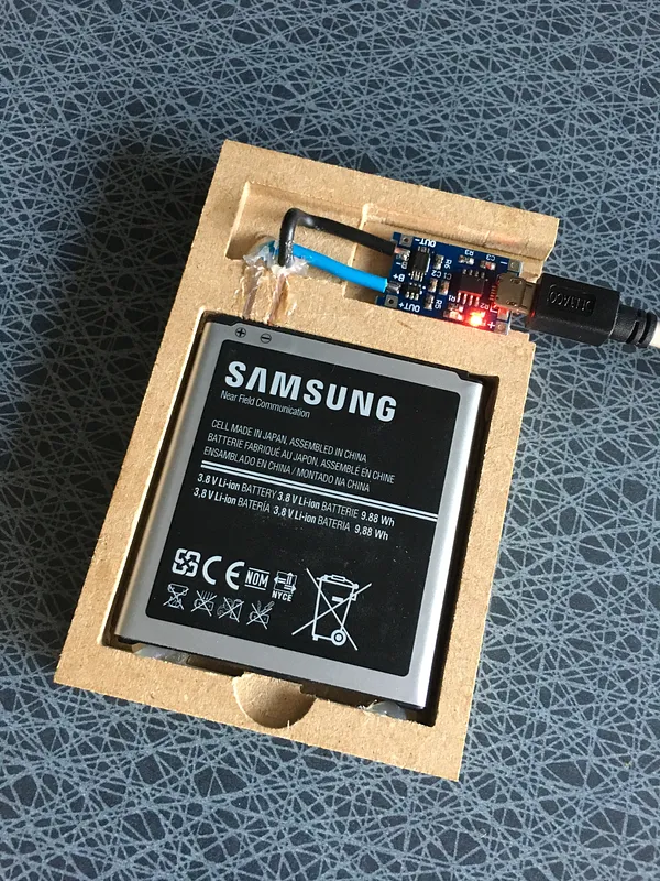

Holder for mobile phone battery, with space for a cheap Ebay Li-ion USB powered charger module.
Pogo pins work well for the connection to the battery + and - terminals. Secure them in the slots with some hot glue.
The dimensions are tailored for a B600BE 2600 mAh battery.
6 mm MDF used.
