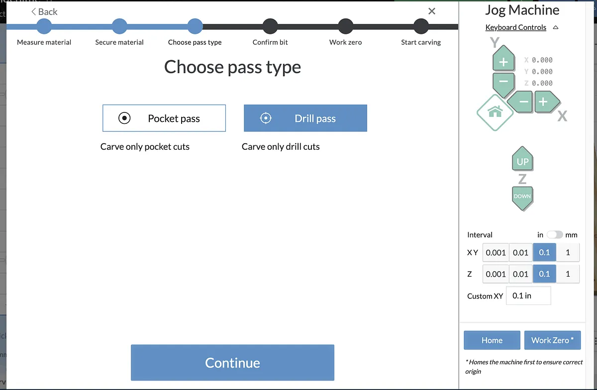

For some reason I cannot get this this to drill the holes, other than that I craved like a dream

Just to make sure you're running the Drill pass in the carve walk through and they won't carve?

When I switch to drill it jogs to the first hole and machine locks up. have to rehome the machine :/

Also what I would recommend is coping your screw holes to another sheet on the same file, you don't have to make a new project. Only copy the holes you want to drill and make sure the is only one bit in your select bit section, then carve perhaps that will solve your issue.

I ended up making a new screen and add the holes, going to try it when I get off work :)

yuppers drilled like a dream
