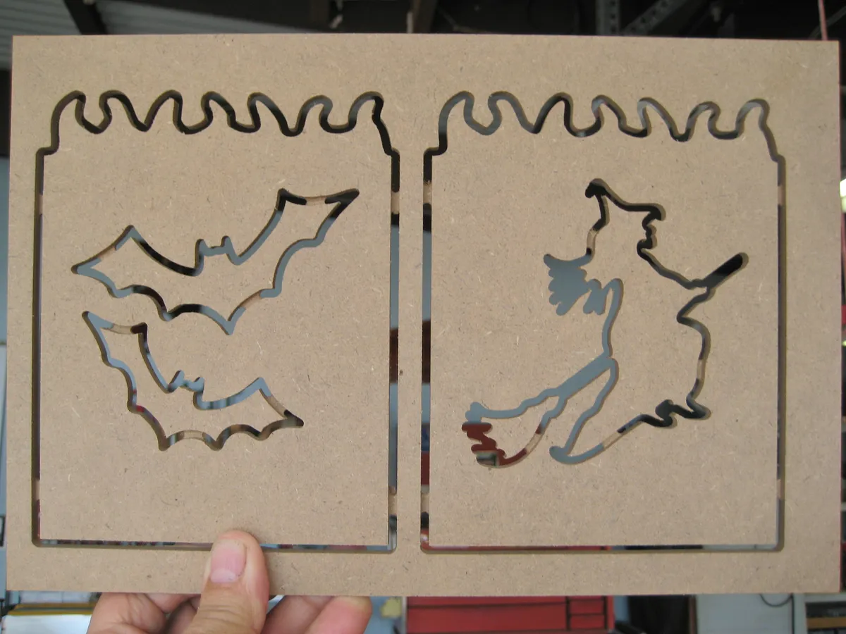

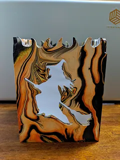

Cut outs
Cut out panels using 1/4" MDF with .125 bit.
Estimated time: 30 minutes

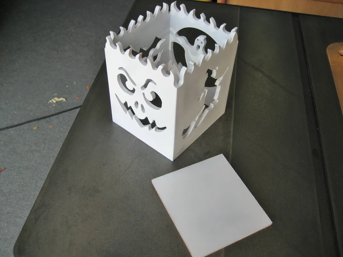

Glue up
Glue panels (and bottom) using super glue. Coat with lacquer sanding sealer, light sand, spray primer, and paint.

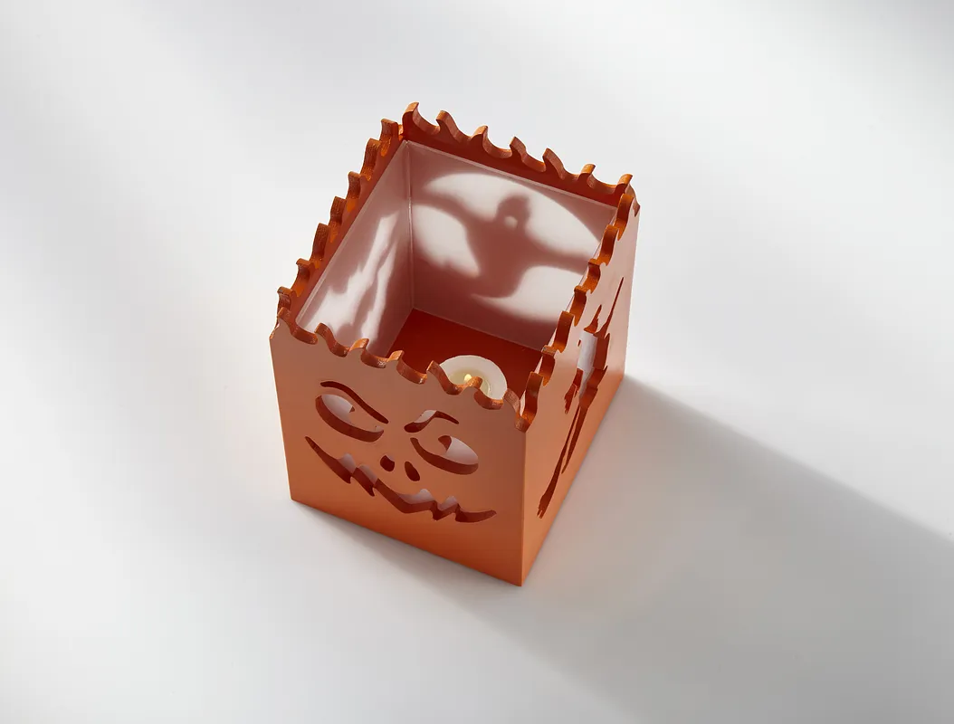

Acrylic box
Cut panels (4 side) to fit inside lamp. Glue with IPS weld on #3 or you can use super glue as well.

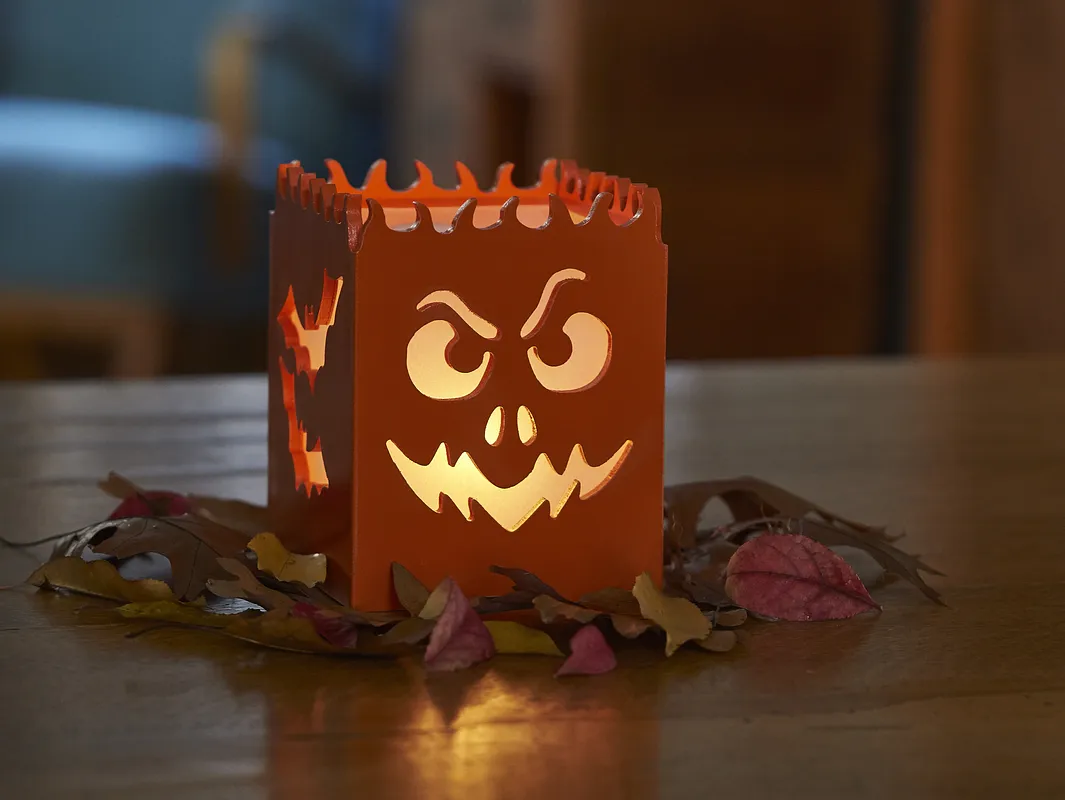

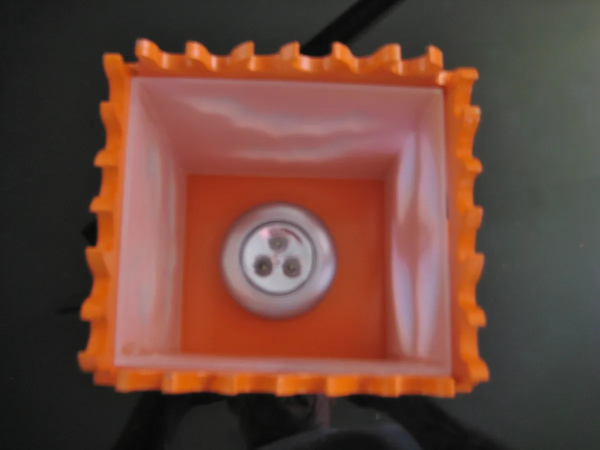

Light
I used a led light for mine but you could use a candle if you prefer. (I think) Haven't tested with candle. Don't know if it would melt acrylic panels after time.
Estimated time: 1 minutes

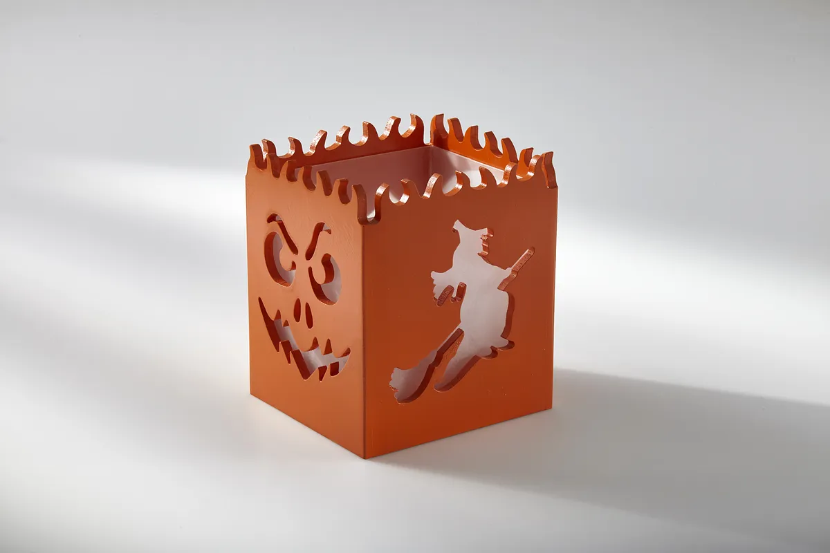

Great project. Made some tiny changes: younger son changed some of the silhouettes, added in a groove close to the bottom to hold the base. Used cellophane as windows. Added text to the base with kids name. Added holes for carrying handle. Son now painting outside. Trick or treat sweety box.
