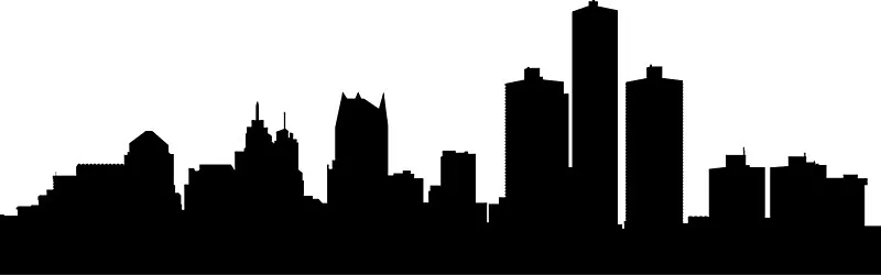

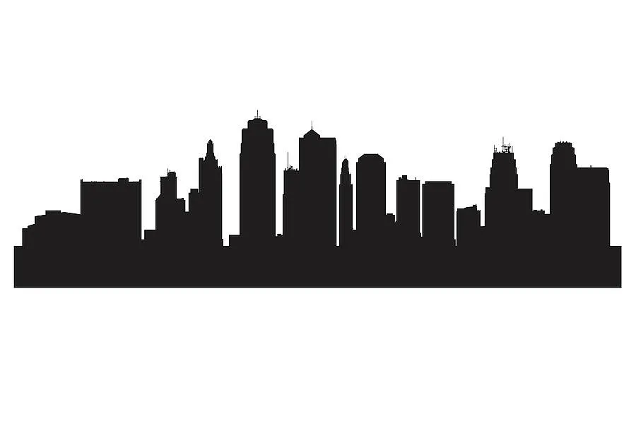

To make this you will need to find skyline pictures of the city skylines you want to use. I used Kansas City and Detroit, the cities my wife and I are from. Google images is your friend here.
You will need to make sure that the ones you find are silhouettes so that it is the easiest to trace.

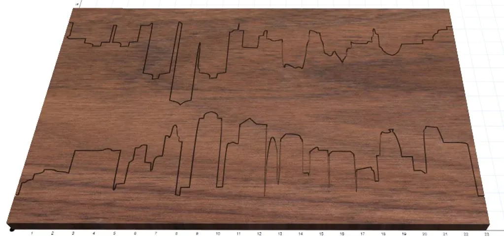

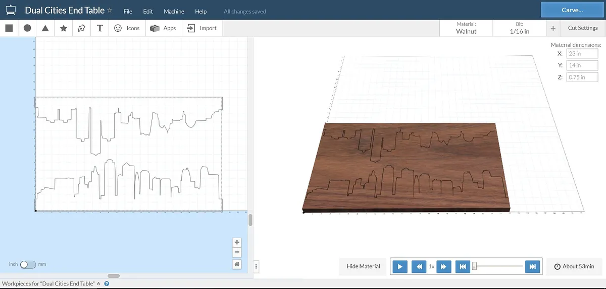

Now that you have your skylines, it is time to import them into Easel. When importing them, you will want to import them as a trace so that it will cut out the outlines of the skylines.
When you have both skylines imported, you just have to rotate one 180 degrees to be opposite the other one and scale them to make them both fit whatever size you plan on making. I made this one relatively small to be used as an end table.
Then you just need to check to see how long the cutting time will be and then cut it out.
