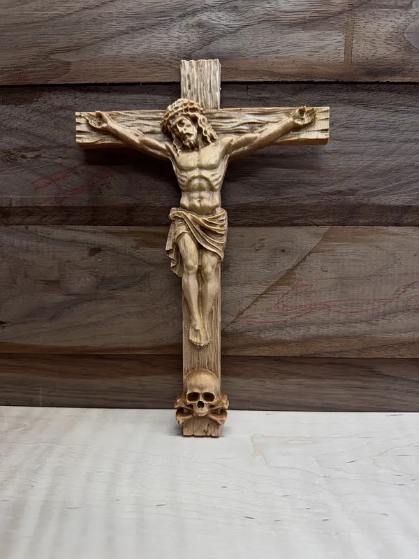

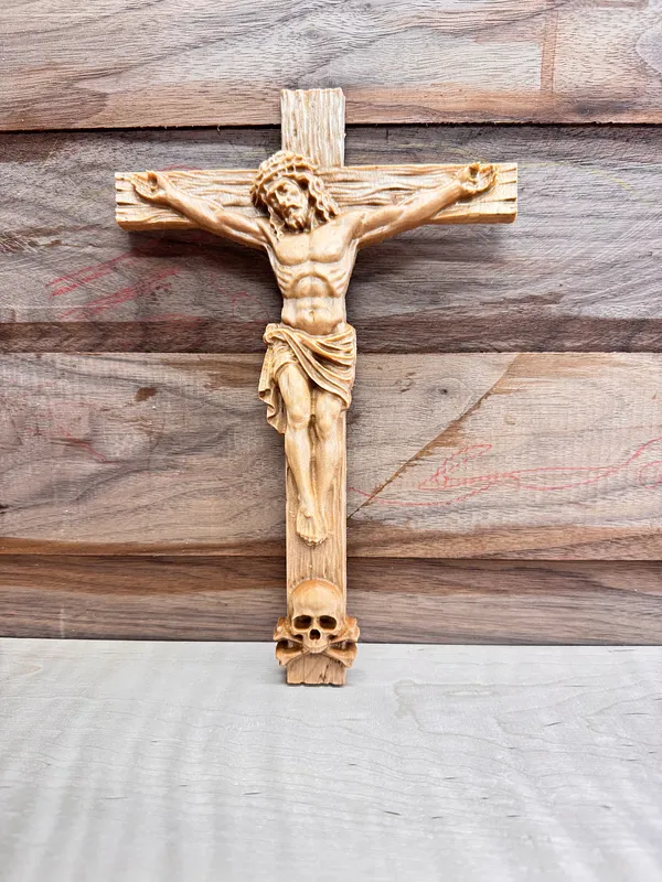

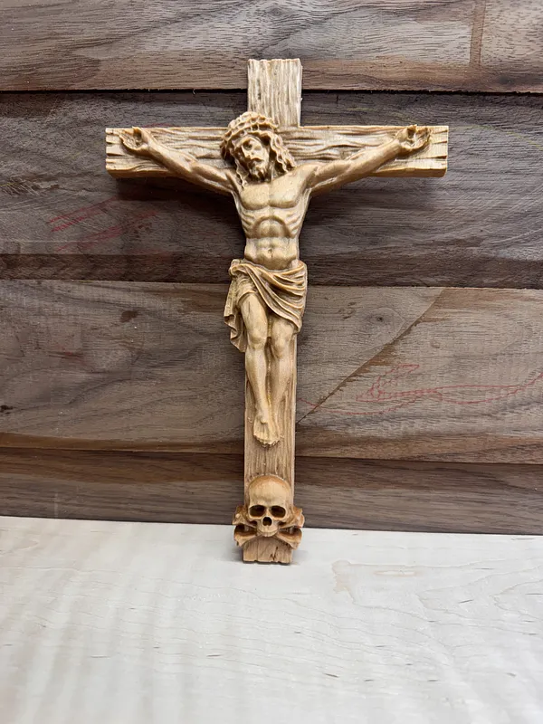

1/8" Tapered Ball Nose & 1/16" Tapered Ball Nose
Speed 18k, Feed 150ipm
The Pirate JC was made on an OneFinity CNC. I used 1/8" & 1/16" Tapered Ball Nose bits. Roughing - Speed 18k, Feed 150 ipm, Plunge 70, Step Over 40%, depth per pass 0.08". Detail - Speed 18k, Feed 150, Plunge 70, Step Over 9%.
