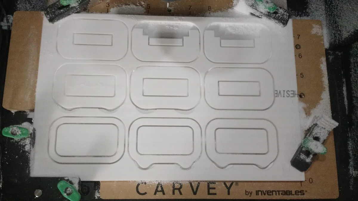

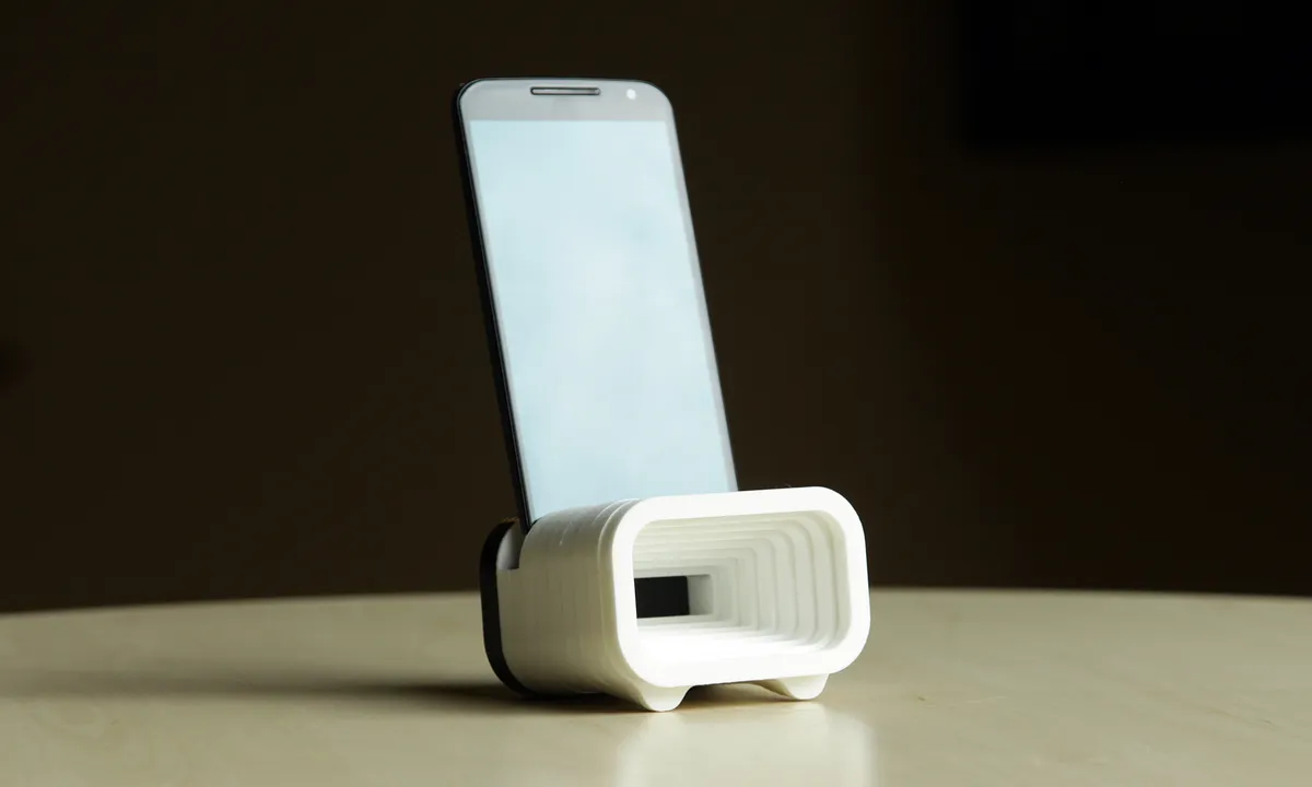

Mill the profiles
Mill the main profiles out of 1/4" material. Use a 1/16" bit for better results on the smaller features.
Phone Amplifier — Mill the profiles
3

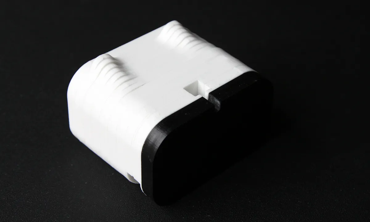

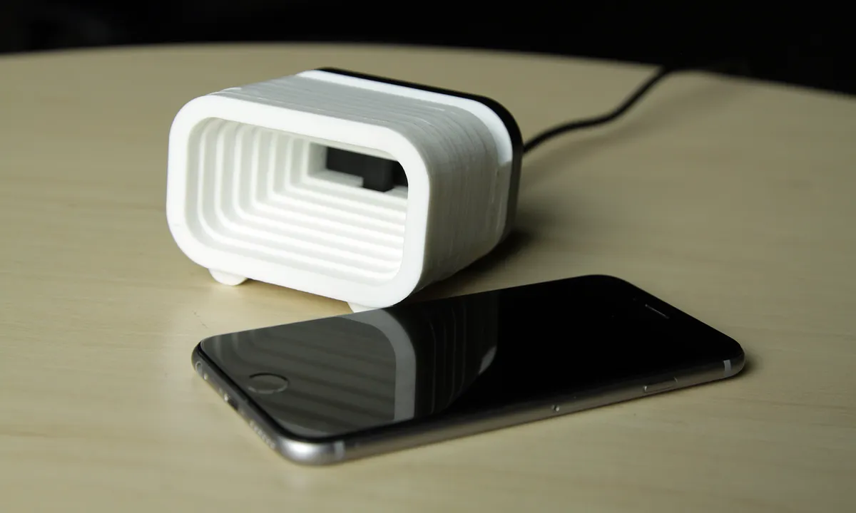

Mill the Back profile
Mill the back piece out of your choice of material. This part will not only provide an accent color, but will help reinforce the thin wall section around the phone slot. 1/2" Black corian provides a nice contrast to the front of the design.
Use this EASEL "link":http://easel.inventables.com/projects/CEyR6H8rWWqhYQU6uE75fA
Phone Amplifier — Mill the Back profile
4
Assembly
Carefully glue and clamp the profiles together one at a time. Super glue is effective in adhering the corian together. Use a clamp or jig to ensure that the parts are neatly aligned to each other.
