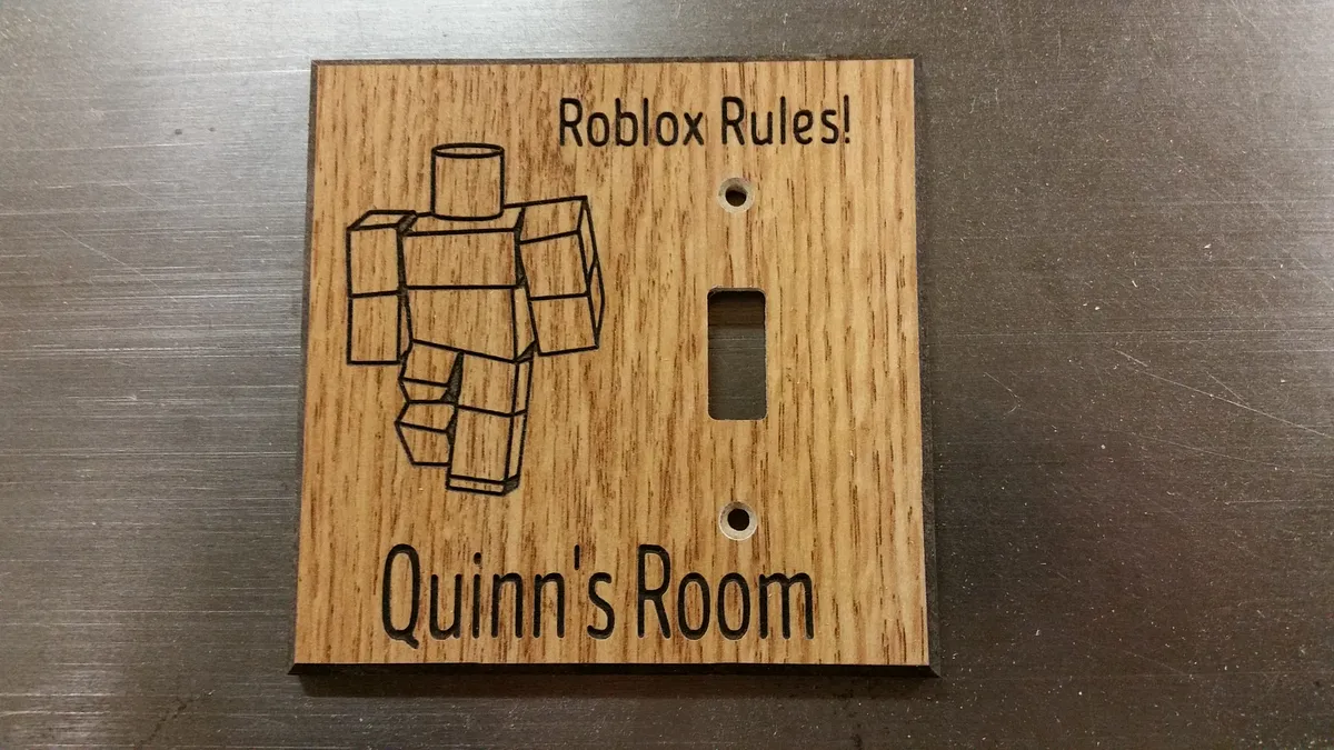

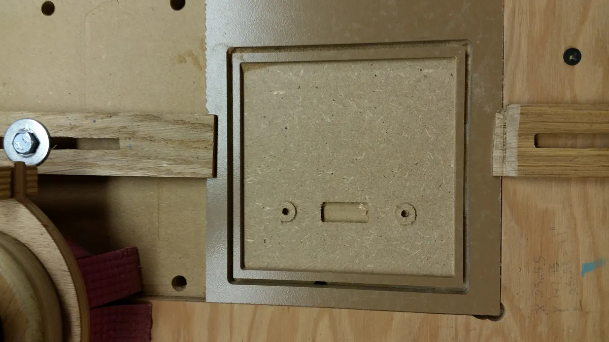

I wanted a larger graphic than the normal plate would handle so I simply made it wider. I cut the back first using the Easel Project linked above.
Cutting the Front

I then flipped it over and moved it to my bump stop and carved the graphic on the front with a 60 degree V bit telling Easel the diameter was .015". Cut depth was .03 in. To keep chip out to a minimum on the laminate flooring use a sharp bit.
When finished cutting I took the plate to my router table and cut a 45 degree bevel around the edge. Could have done this in the X-carve but much faster for me on the router table.
I then applied a dark stain to the beveled edges and into the carved graphic and text. On the surface areas just used a small brush to get the stain into the carving. Excess was easily wiped off the pre-finished surface.
Also, the photo of the back shows the entire area milled out. This was a test run and on the final I just cleared part of it as per the Easel drawing.
