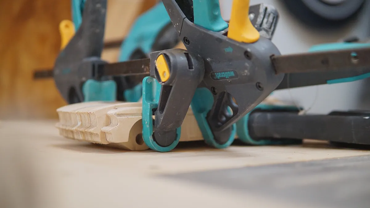

glue together
i glued it in steps together to get it exact matching. Orientation is the rear. Take car to clean squeeze out before drying.

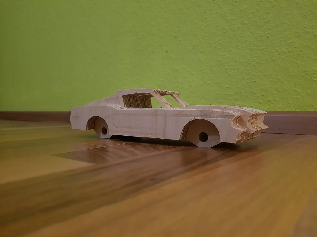

Cleaning tyre holes and mount axis
take car to clean the holes for the axis. The axis is a round bar of 10 mm diameter, i glued one Tyre into place. After its dry i put the axis in, dryfit the other Tyre and cuted the axis to lengh. Afterward i glued it up.

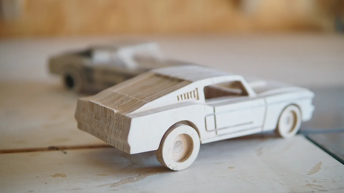

Finishing
This step is the most intense. If you are worked precise before it will be easier. You have to sand everything i started with 120 grid and ended be 320. You can sound the edges if you like.
At the end I coded my car with furniture wax.

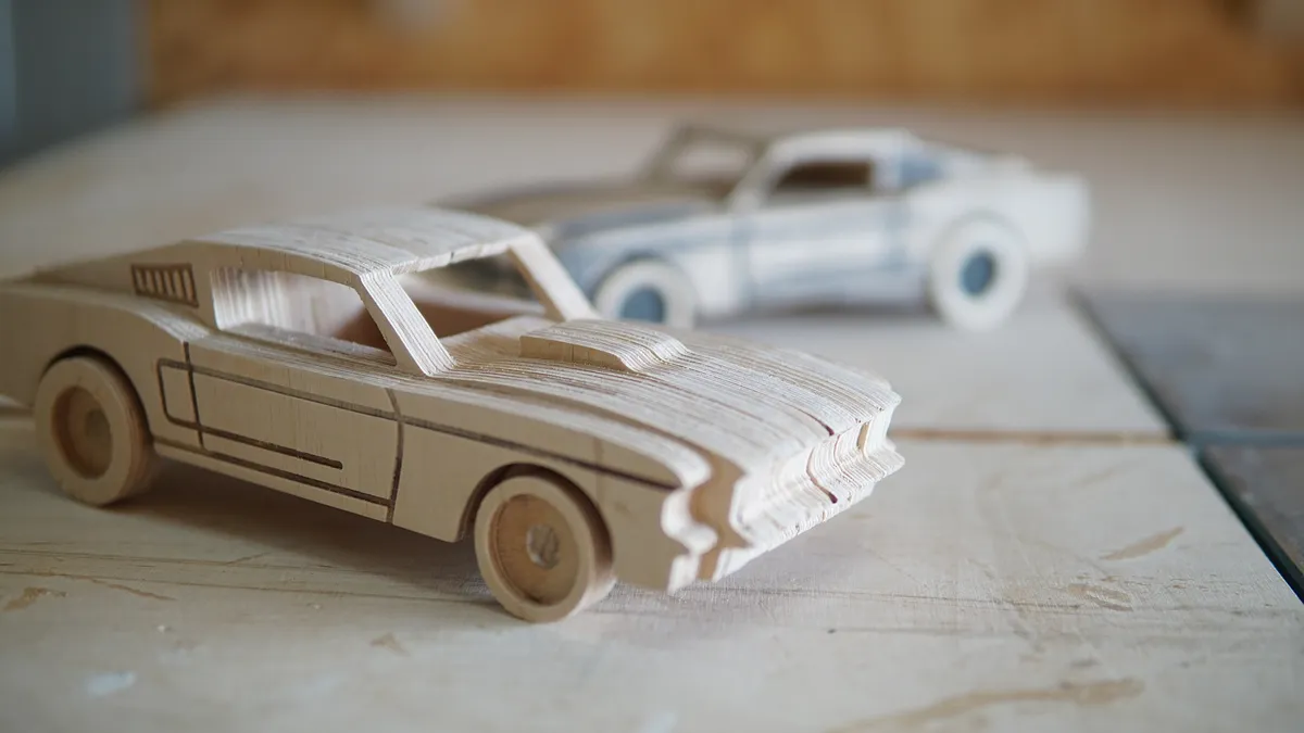

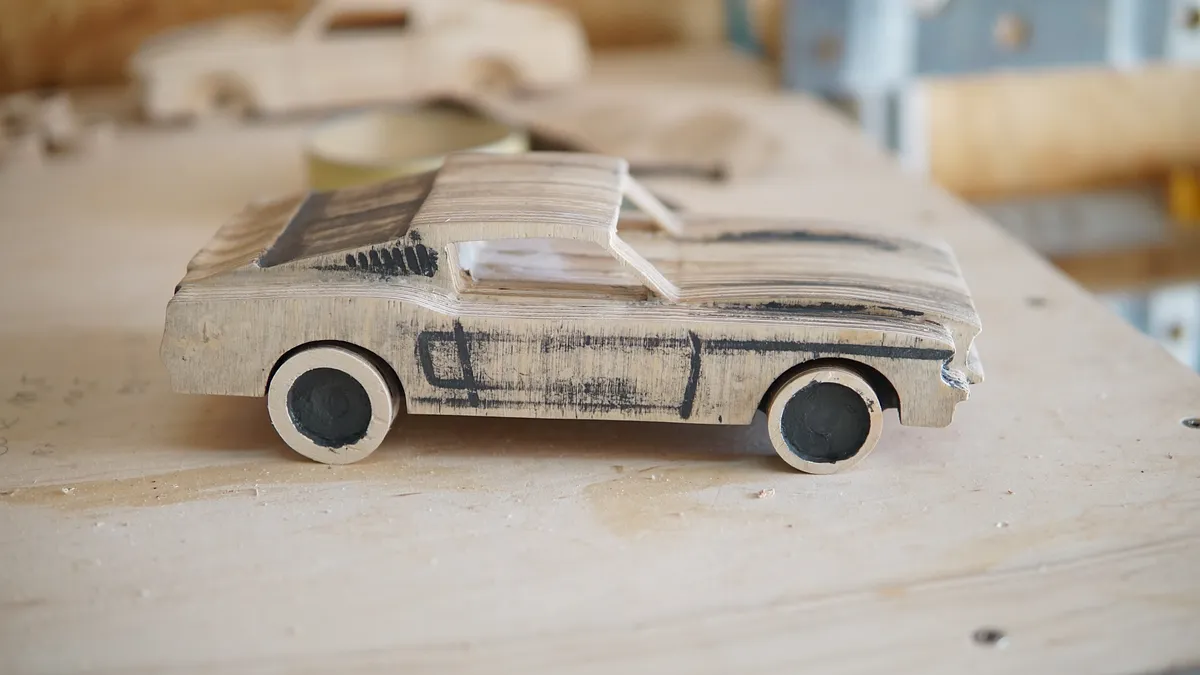

The other car you can see in the picture got some patina before by using chalk paint.
