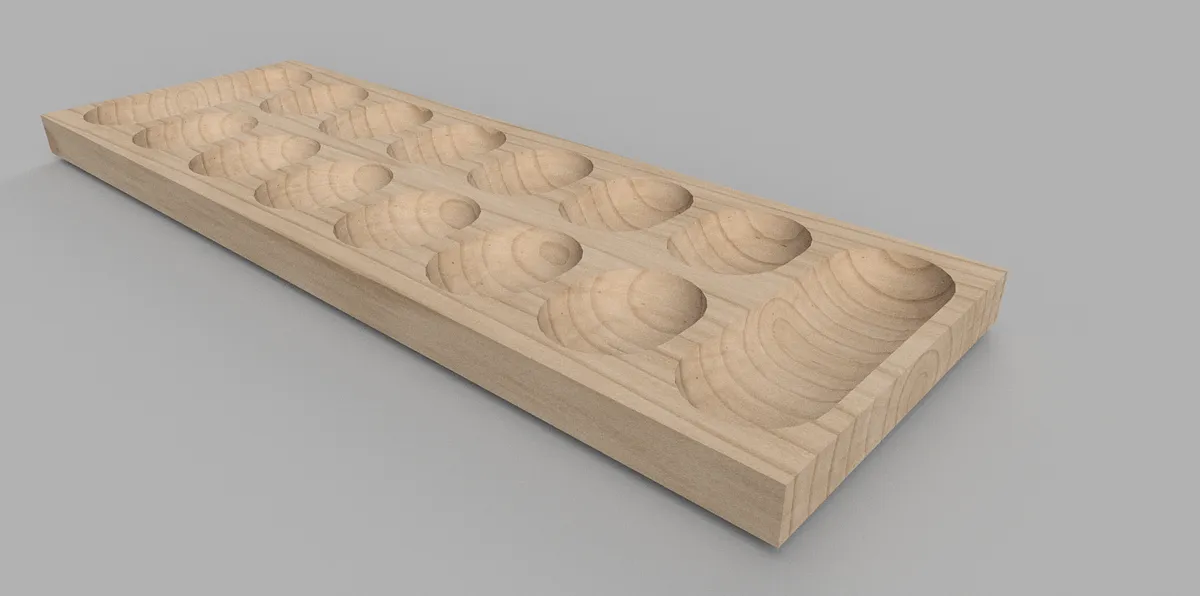

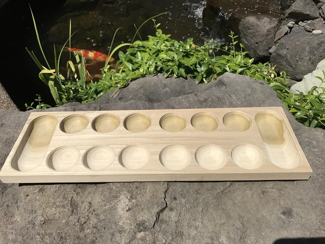

Prepare Board
Cut a 5.5 x 16.25 x .75 board for your Mancala game board.
Place Board in Machine
Place board in machine with the long end in the y direction. You will cut half of the board first then rotate and cut the second half. Make sure the lower left of the board is at your origin on your machine so it will center correctly.
Open Easle Project and Cut
With your board in the correct location and held down appropriately, run the program to cut half of the Mancala board.
If you design to make changes to the model you can download Fusion 360 and access the file there to make edits to the model/tool paths. "model":http://a360.co/2sacSXl
Rotate Board
Once you have finished cutting the first part of the board, rotate it 180deg and position it in the same location and cut the other side of the board.
Sand and Play!
Take the board off your machine, sand and play!!!
