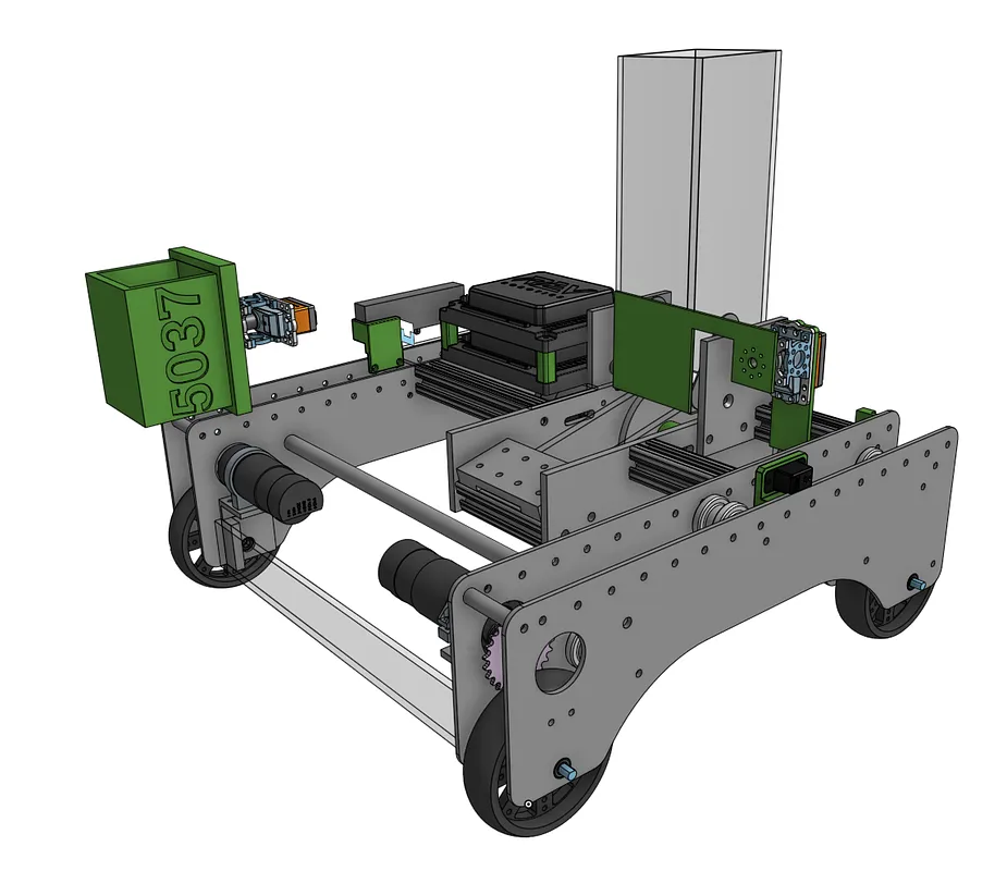

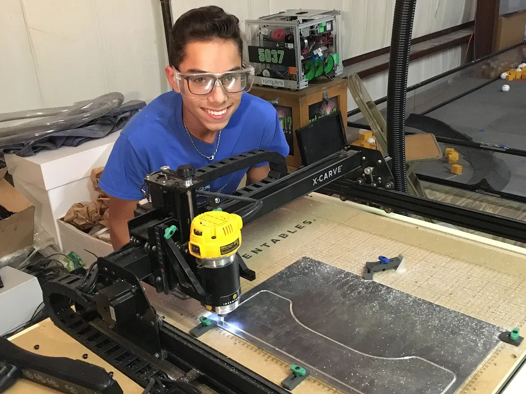

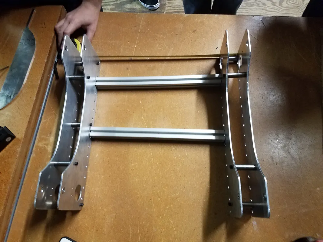

We cut 4 - 1/8 inch aluminum plates to form the drive train and chassis platform. Andy Mark Churros are used as standoffs between each drive plate and the two halves are connected with 8020 1010 extrusion
