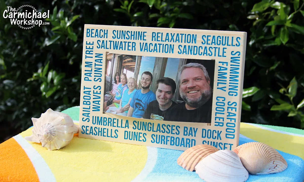

Prepare Wood Blank
Cut a wood blank that is .75" thick, 11.5" wide, and 7.25" tall. The frame is designed to be 10.5" wide, so the extra 1" width allows .5" of clamping space on each side. I used 1x8 pine, but any wood will do.
Clamp and Carve
Clamp the wood down to the wasteboard. Place clamps on left and right sides only. Keep clamps within .25" from the edges of the board to allow for bit clearance.
Install a 1/16" bit. Position the bit at the bottom left corner of the board and carve. Carve time is approximately 47 minutes. When finished carving, use a table saw to trim off the extra width that was used for clamping.
Estimated time: 60 minutes
Sand and Finish
Sand any fuzzies off the carved surface. Apply paint or finish of your choice. Cut the picture and a piece of clear acrylic to 7.5" wide x 3.75" tall. Bend and wedge the acrylic and picture into the grooves.
Note: To remove the picture and acrylic, bend them to relieve the force from the edges of the grooves. If you pop out the ends, the acrylic can catch the edge and chip out the face of the wood.
Estimated time: 30 minutes
What size photo is this designed for?
Andy Hawkins · November 03, 2021
You can change the design to fit any size. I thought I was going to have to measure it, but I see in step 3 that I said cut the picture and a piece of clear acrylic to 7.5" wide x 3.75" tall. Bend and wedge the acrylic and picture into the grooves. So 7.5" wide x 3.75" tall.
