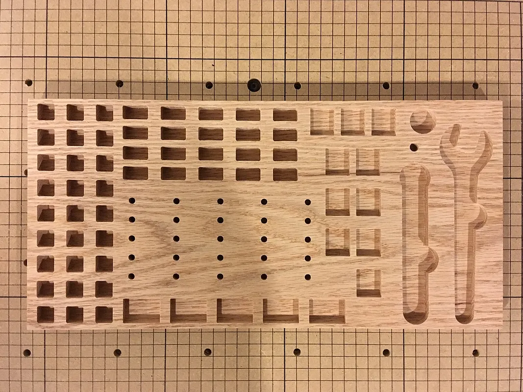

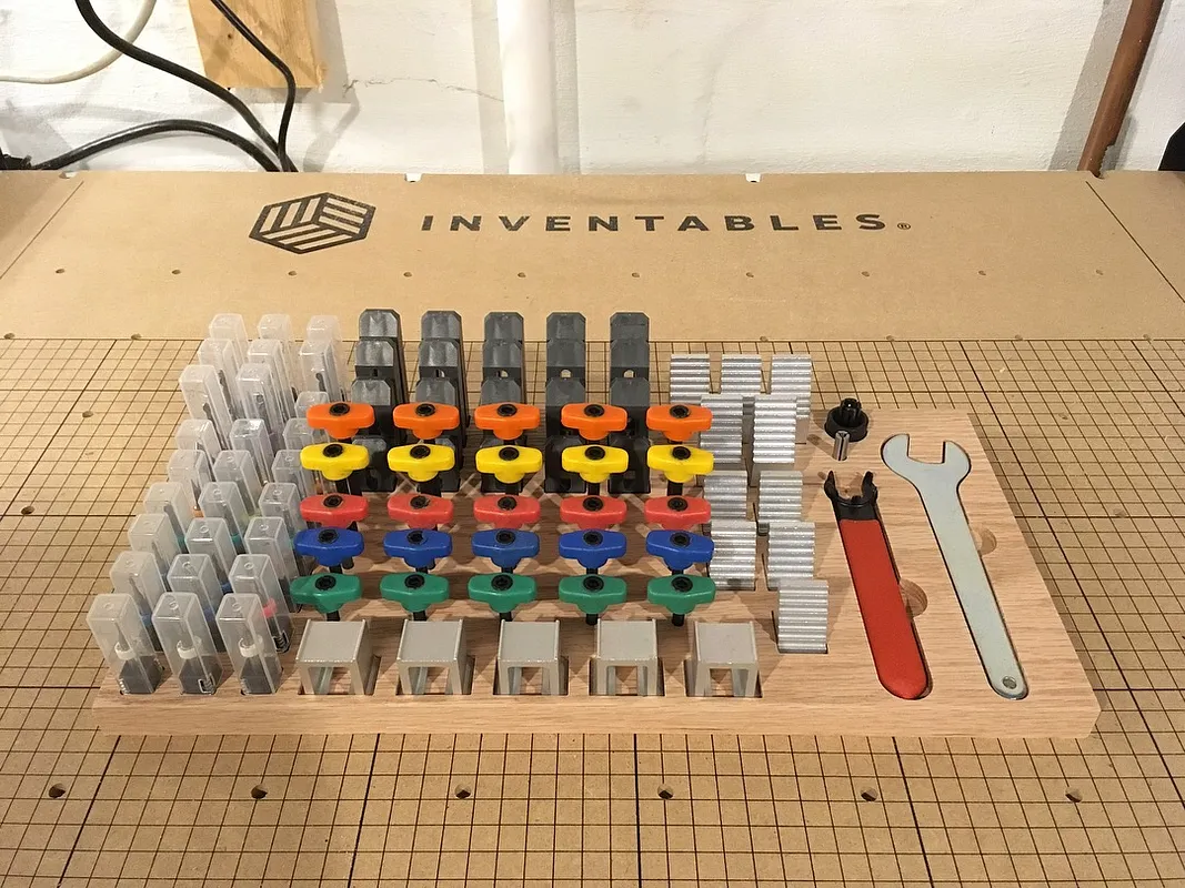

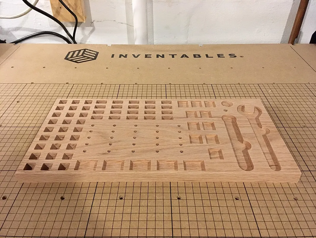

I adapted this from Tim Singh's design to make it work for my needs. This fits the complete clamp set for the x-carve, 27 bits in their cases, basic wrench, precision collet wrench, the 1/4" collet and the 1/8" collet adapter.
Hard Maple
One edit I would make to this would be after you cut the fill out for the precision collet wrench, go back and do an outline on the path to make it a little bigger, or make it about 2 mm wider in Easel before cutting. I apologize for it being a little small.

Scratch that! I didn't realize that as I edit that project it updates to the public. So I believe it is fixed. I would delete the comment above, but it won't allow me. So the problem should be fixed. Precision collet wrench hole should be x: 31.5mm and y: 130mm.

I made one similar to yours added some extra spaces and really happy with it thanks for the idea!!!

So I got it carved and everything wound up just a tiny bit too small, oddly enough the only thing that fit perfect was the wrench.
