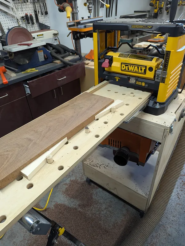

Put the sled to use

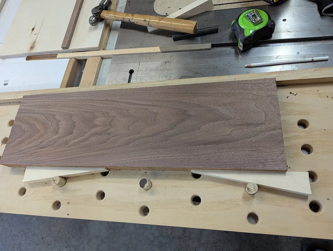

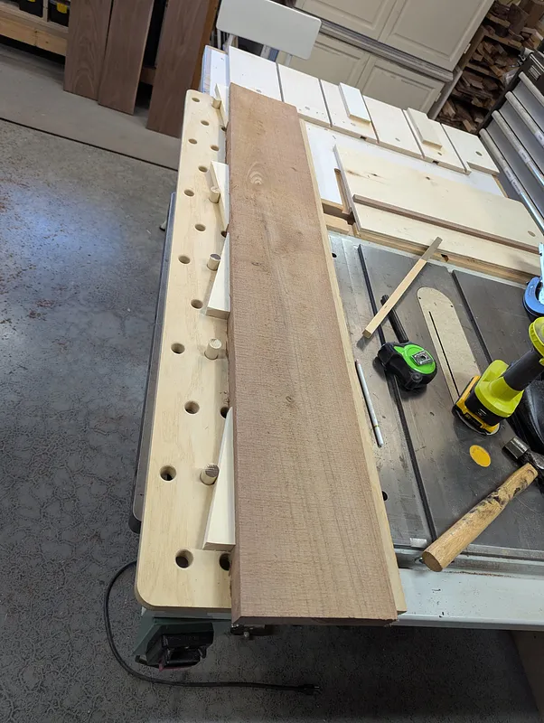

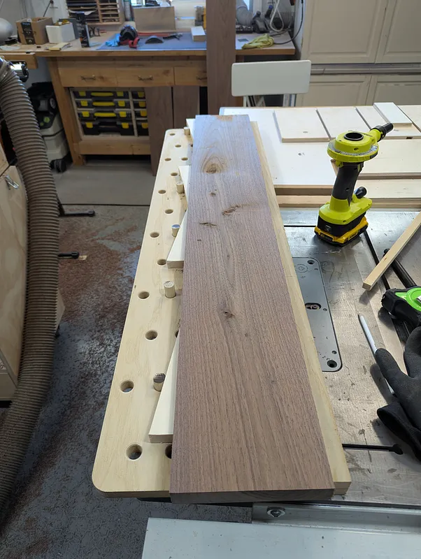

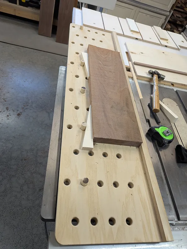

Take your board and butt it up against the straight edge. If the board is especially twisted you may want to shim it relatively straight underneath. Insert dowels in the nearest available holes that can have wedges inserted. Hammer the wedges between the dowels and the board in several locations. You'll want to make sure they are all snug, but don't get crazy with it.
You can now run the sled through the planer. You may want to setup infeed and outfeed rollers to keep things level on both sides and to assist holding the jig since it is quite heavy. Once you get one face flattened you can knock-out the wedges and flip the board and run it through the planer by itself to get 2 square sides. You can then joint an edge on your jointer if you have one or use a track saw or table saw with a jointing jig.
