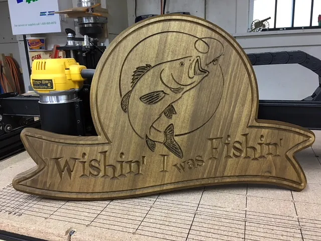

Create a work area of 22x16 inches in a new project window. Then add a circle and a banner from the icon section in Easel. Combine the two elements after placing them in a position that is pleasing to you for your design.
Next select the off setter app and create using a .5 off set.
Next, enlarge to fit work area and add fish design to project. Next add text.
Set depth of cut for all elements of your design.
Carve, I used a 60 degree bit to carve the fish to preserve the details of the design and then changed to a 90 degree v bit to carve the remaining.

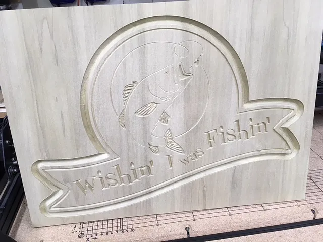

Thanks for the file. It worked out very well. I am still learning on the Pro. It did not stop for a bit change for the 90 degree bit to cut the outer perimeter. It used the 60 degree for the whole job. Not sure how to get that setting. It carved great tho with the 60 just a little burning but ok.
