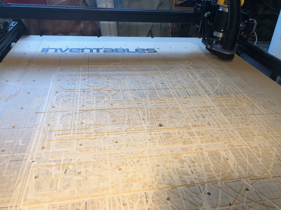

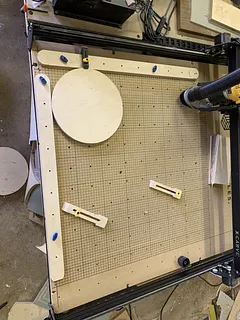

Want do make your own waste board? Want to manually drill all 144 holes perfectly? me neither. let your xcarve do it for you. Delete the ones that you dont need if your machine is smaller than mine. :)

In my particular situation, it did not line up to original holes. I have the 1000 x 1000. What would dead center coordinates be? Hoping that was my error..
Rick, I designed it to be zeroed at 0x0 so that it could be resized to any unit. Just centre you bit over the 0x0 and it should work fine like it did for me.
I'm about to try this but have a few questions. the holes say .625. my news wasteboard is .5 sgould i change the depth? Also my new wasteboard is 37x39.25. If i set my position to 0 and 0, is it going to carve in the right area?

Thanks!!! I was wanting to make one to go on top of the original and use the existing threaded inserts to tie it down! AWESOME!!

Thomas, yes it is meant to lay overtop of the original so you can use the original threaded inserts.
MICHAEL ILLINGBY · June 06, 2020

Had the same issue. holes didnt line up. have no idea where to set zero now. Any suggestions?
