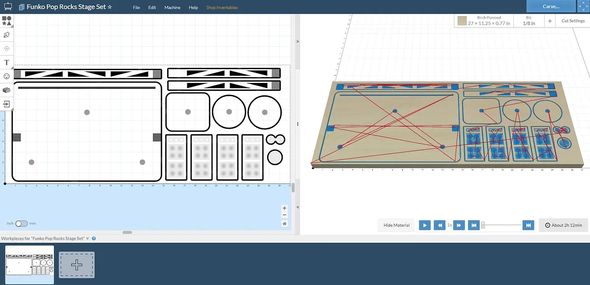

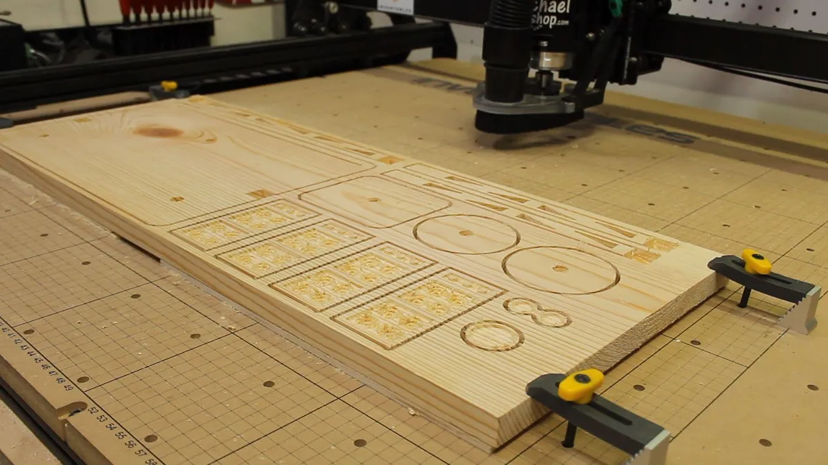

Carve It!
This project takes over 2 hours to carve with the current settings. It can be carved from a 27" section of 1x12 pine from the home center. (.75"x11.25"x27") Clamp it securely and carve the project with a 1/8" two flute straight bit.
Estimated time: 120 minutes

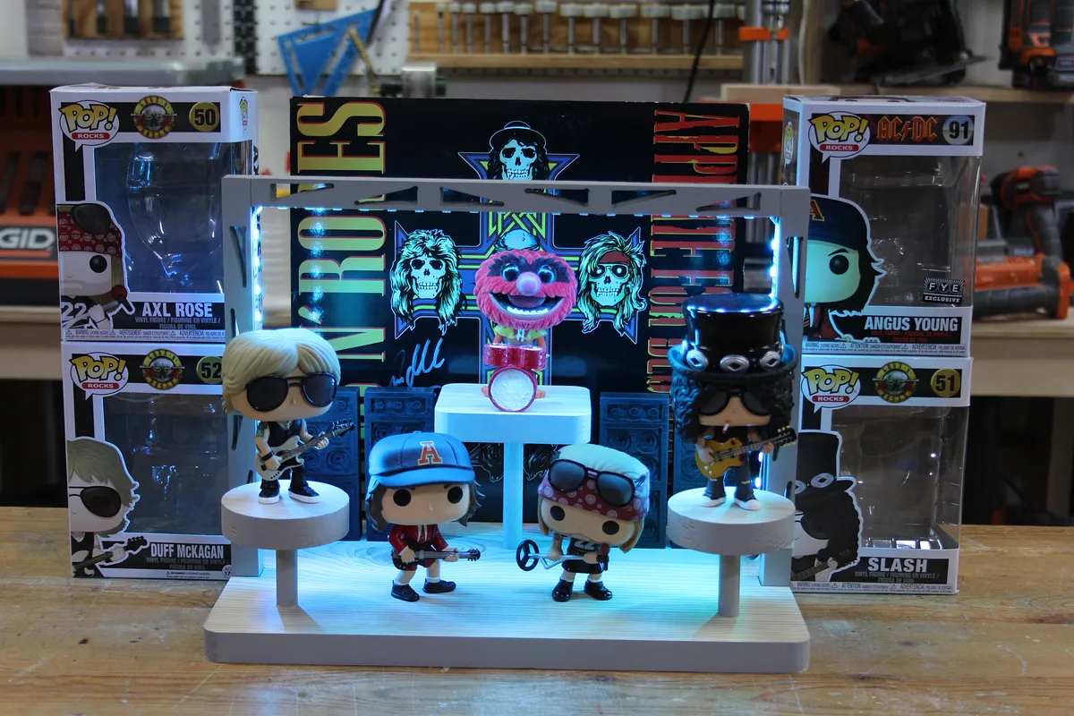

Sand, Paint, and Assemble!

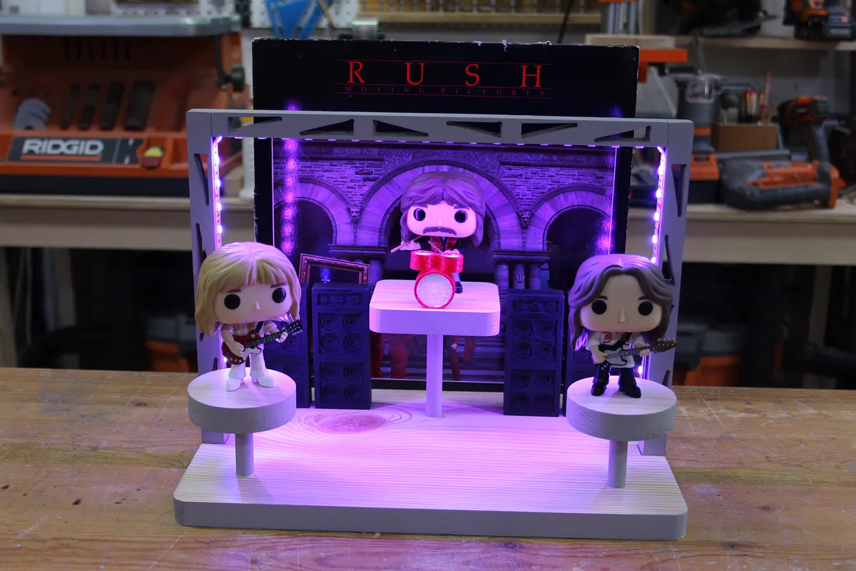

Separate the parts from the board and sand everything smooth. I recommend leaving the top surfaces unfinished as some paints/finishes could damage the vinyl Funko Pop figures. I painted some of the parts that would not touch the figures to add some color.

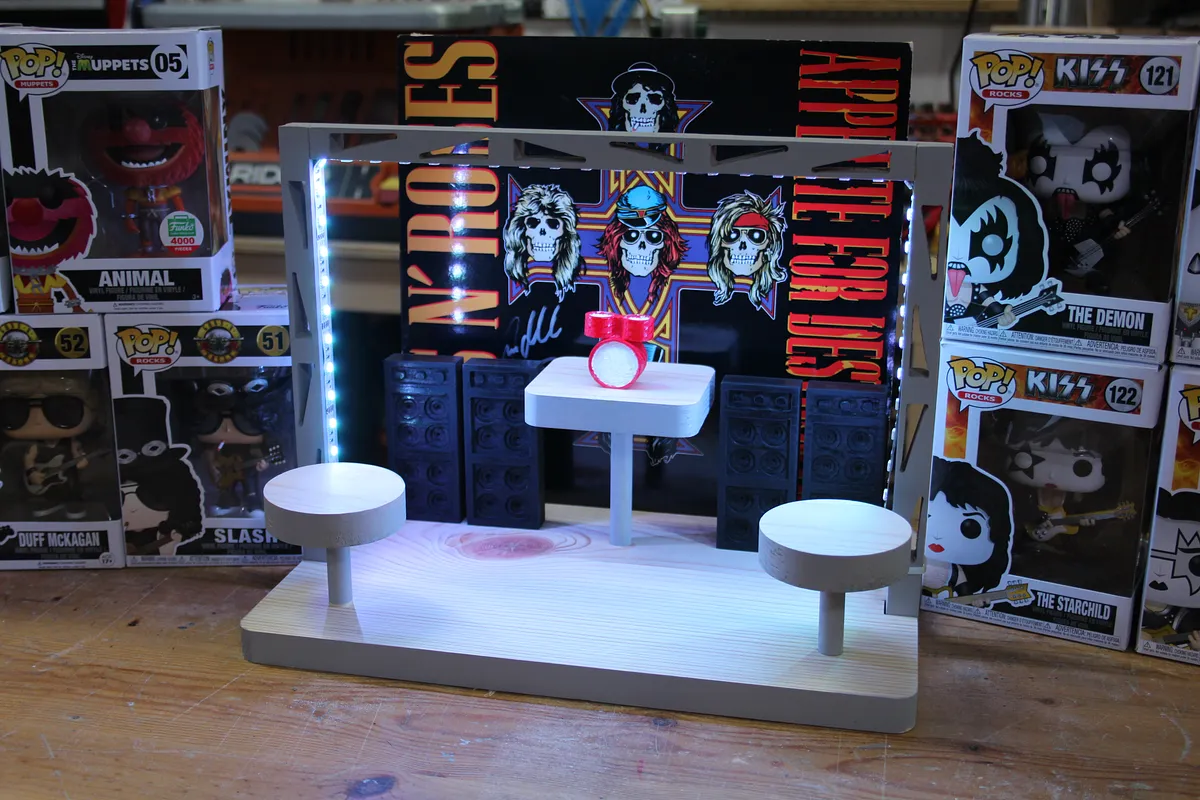

Glue together the lighting truss parts and attach a strip of LED lights (optional).
Glue together the little drum set. Some Funko Pop Drummer figures do not come with a drum set, so I included one in the design. :)
Cut three pieces of 1/2" dowel rod to support the stage platforms. If you like, cut lots of them at different lengths so you can vary the height of the platforms.
Estimated time: 45 minutes
Light It Up!
Slide a record cover album into the groove on the main stage for a back drop. Position your Funko Pop Rocks figures on the stage, then light it up! Have fun and enjoy!
