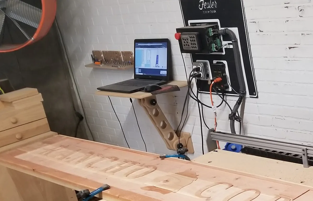

Materials required
1 ea 2'x4' .75 MDF (or your choice of plywood) 2 ea 3/8" x 4 hex bolts 2 ea. 3/8" threaded knobs 10 ea 3/8" washers (insert washers between arm mounts for smooth operation).
Note: My machine is set up to cut 31"x60". You will need to configure the parts to suit your machines capabilities.
Estimated time: 180 minutes
