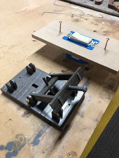

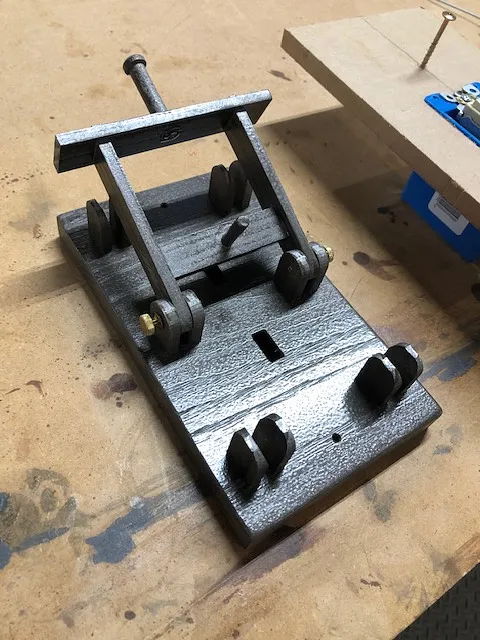

Steve's Knife Light Switch
Knife Switch Switch for your shop or Man Cave
x-carve 2016
Birch Plywood, Hard Maple
(1) 5/16" x 1-7/8" Peg (adjust length as needed) (1) 1/4" Wood Dowel 2-1/4" Long (2) 6-32 X 3/4" Knurled Head Screws You will need to taper the 8 outside legs on the inside so the actual throw will slide in easier 6" x 10" x 3/4" Oak 7-1/4" x 12" x 1/4" Pine
