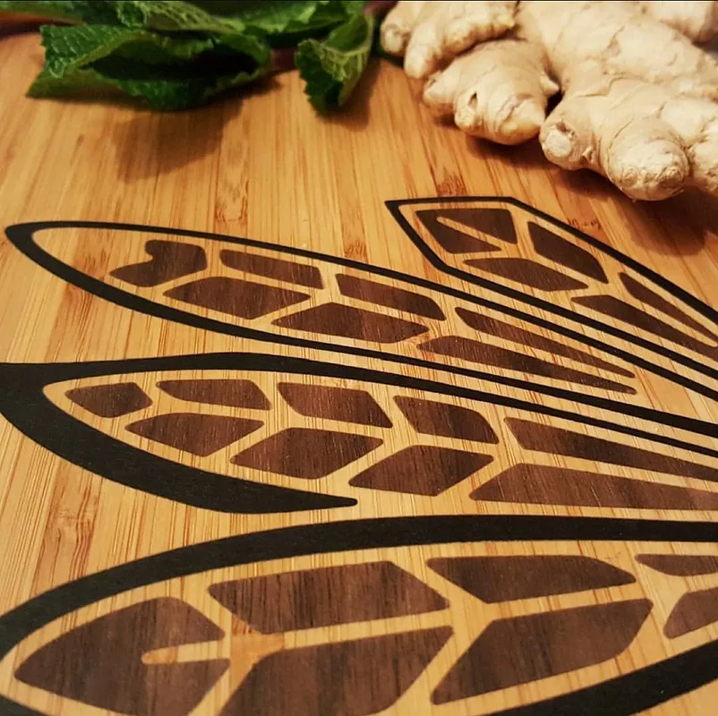

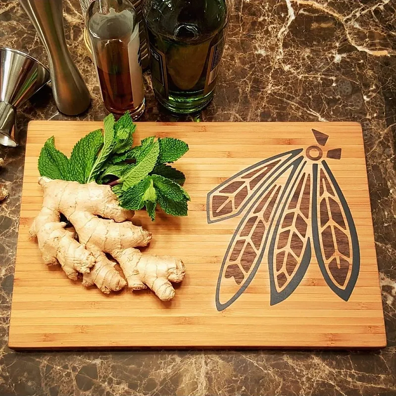

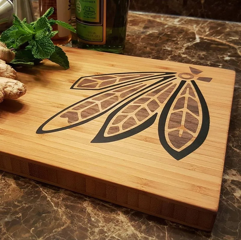

I used bamboo for the base, and a mix of thin acrylic and walnut for the inlay. Be sure to update material thickness and cut depths to match your material. I used double sided tape instead of tabs to help reduce sanding / finishing work.

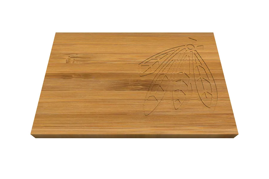

How can I separate all of these shapes? They are all grouped together right now
JulesPro · May 15, 2026
select the shapes, then right click (or select "Edit", then select "Separate"
Natalie SturdyPro · May 15, 2026
From there, you can create new groups if you want to keep the individual feathers grouped together for example
