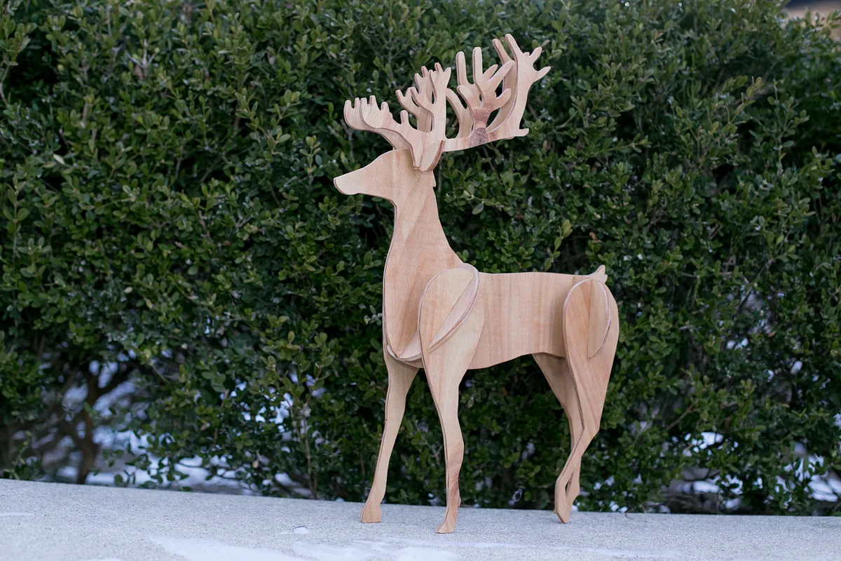

This project was designed to be used with 1/4" plywood, but 1/4" plywood is normally thinner than 0.25" (closer to 0.20" which is what this project is designed for). If your material thickness differs from 0.20" you can easily adjust for it by changing the endmill width in Easel.
This works by tricking Easel into thinking you are using a larger or smaller endmill than you actually are. This causes the calculated cutting path to actually cut more (or less) material than the original design, effectively making the slots bigger (or smaller). To calculate the value to enter into the Bit Diameter parameter in Easel, use the following formula:
Easel Bit Diameter = Actual Endmill Diameter + (0.20" - Material Thickness)
If your fit ends up too tight or loose, you can come back to this step and adjust this accordingly to get a better fit.

Assemble the parts using the project photos for reference. I found that my plywood thickness was not constant across the material and I had joints that were both too tight and too loose. I sanded the tight joints until they fit and used a dab of wood glue in each loose joint to secure them. I would encourage a bit of glue in each joint anyway to keep everything nice and secure.
