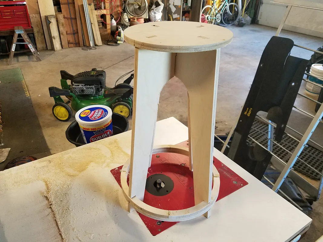

Assemble
Assemble legs and seat, then turn upside down on work surface. Apply glue to one face of C shaped pieces. Begin assembling them, overlapping ends and working around the stool, clamping as you go around.
Turn stool right side up, remove seat, apply glue to tenons and top edges of legs and re-install seat.
Allow to dry and then enjoy.
