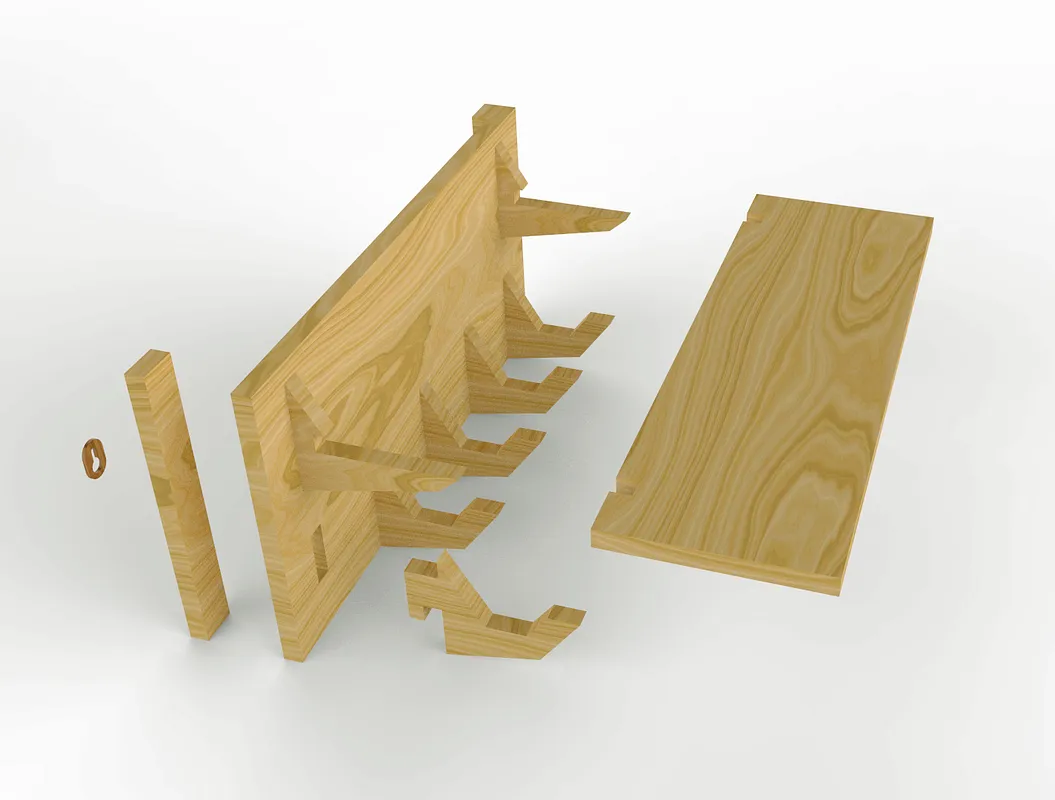

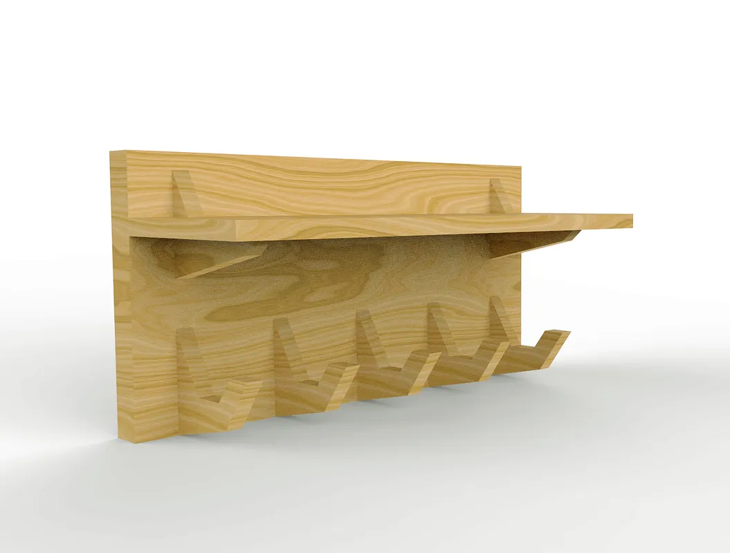

Assembly
Check if all parts are well carved and sanded before assembly. You should have a board with 7 carved rectangles, a shelf, 5 "C" hooks, 2 "L"hooks, 2 frame profiles and 2 walnut structures for wall mounting. Glue together the walnut structures in the circular void in each frame, after that frames can be glued together in the back of the board. Let them dry. At this point it can be already installed on the wall with 2 ø5mm screws. After that, all of the hooks can be placed by pushing them into place and then forcing down gently to join everything together ("C" hooks go on the lower row and the "L" hooks go on the upper one). Assemble the shelf carefully in the upper "L" hooks. Done!
Estimated time: 10 minutes
