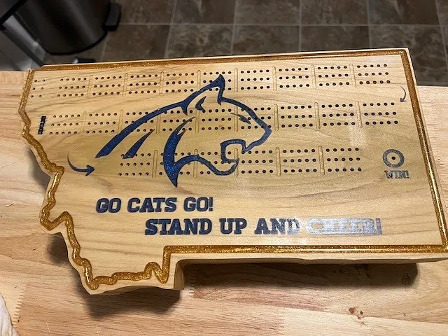

A friend reached out to me for a couple projects for a silent auction to raise scholarship funds for new students. This was one of those pieces!
X-Carve
Birch Plywood, Pine
When I brought in the state line of Montana to Easel, it wanted to do this weird double line as you'll see in the copy. I decided to use it to my advantage and let it cut out the outer line full depth, then stopped it about .25" down in the inner line to make a channel for epoxy!
