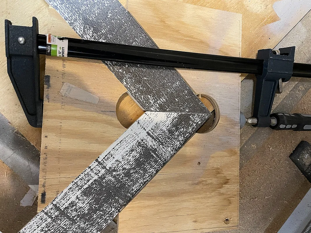

90 Degree Frame clamp
This is a template used to clamp 90 degree corners for picture frames. Miter the ends at 45 degrees then clamp and glue using this jig.
