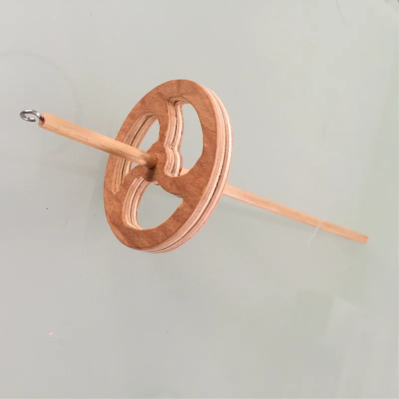

Cut wheel halves
Cut out the wheel halves on the x-carve using the digital design file.
Estimated time: 16 minutes
insert the balast
cut two 4.3 in. lengths of eighth inch dia. 50/50 solder and insert one each into the grooves in the wheel halves. Glue the halves together.
Estimated time: 4 minutes
make the shaft
cut a ten inch length of quarter inch dowel. taper one end by spinning it against a sander. Screw a threaded hook into the other end. If you can't find a tiny hook, you can make one by opening an eyelet with pliers.
Estimated time: 5 minutes
Insert the shaft
Insert the shaft in the wheel leaving the hooked end protruding approximately two and a quarter inches from the wheel.
Estimated time: 1 minutes
finishing
Rub with boiled linseed oil. Let dry over night.
Spin
Forever actually.
For spinning instructions follow this link:
https://www.youtube.com/watch?v=7R0Lb1qA7kE
Estimated time: 220 minutes
