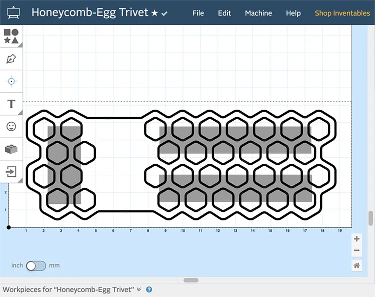

The original design was made in Adobe Illustrator. I have included the SVG and the AI should you want to edit them.

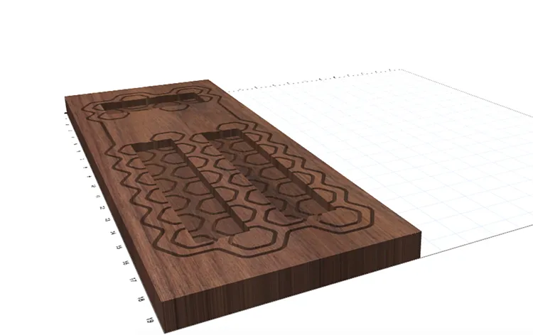

In Easel, I added the depth carving to allow for airflow below the trivet. It is not in the Illustrator files. Change this depth to whatever you're comfortable with, I chose approximately half for time and to make the trivet a little lighter. It turned out to be a good decision.
At first, I used a 1/8" straight flute bit, It broke. I changed to a 1/8" spiral upcut bit at the suggested setting for walnut and the remainder of the project was smooth.
Set the cutouts to carve on the inside path and the outline to carve on the inside path.

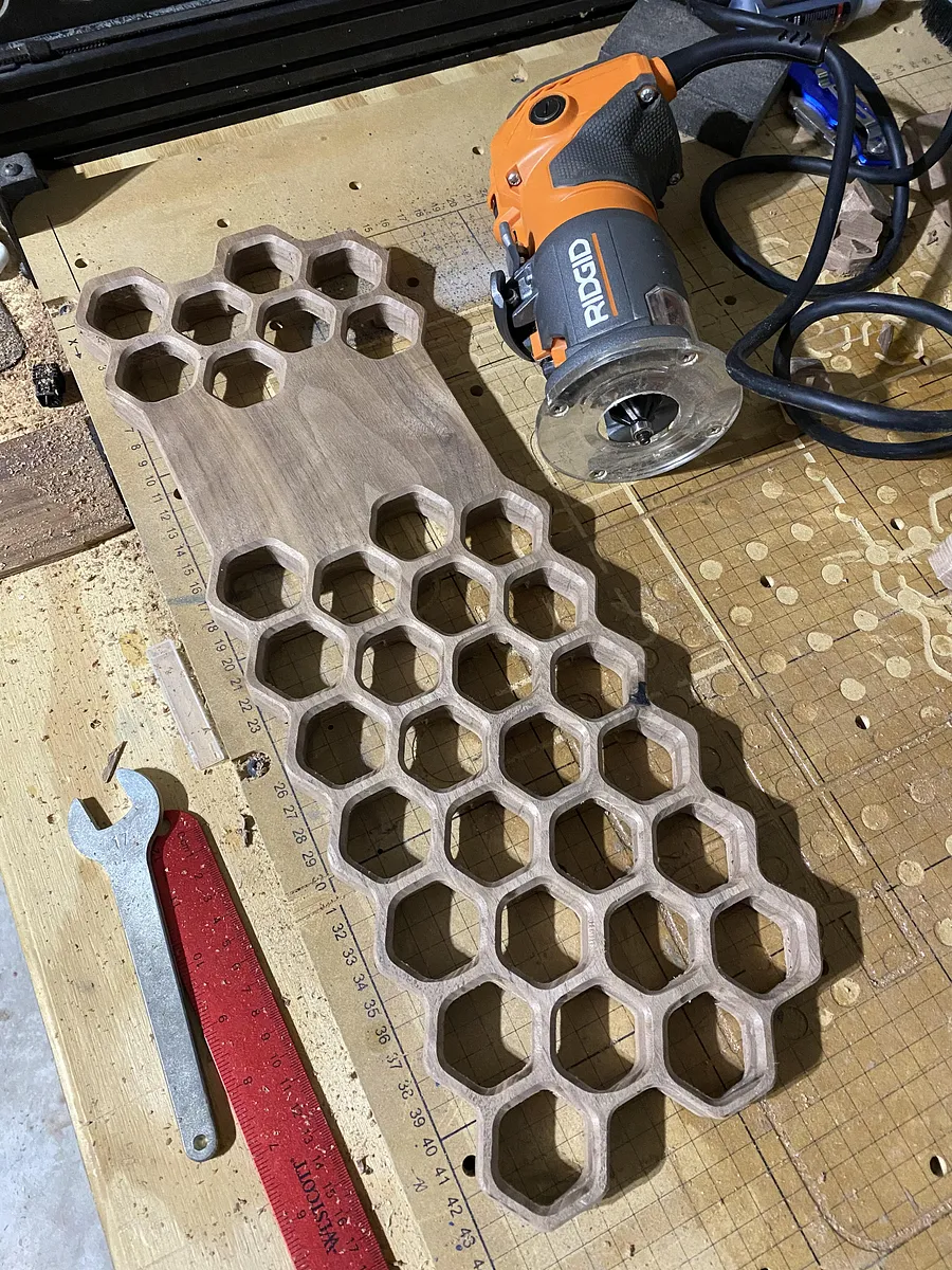

To give the trivet a more appealing look and to clean up the remaining tab marks, I went with a 45-degree bevel with my palm router. I went slightly deeper on the inside. This worked like a charm. A round over bit would do a nice job as well.

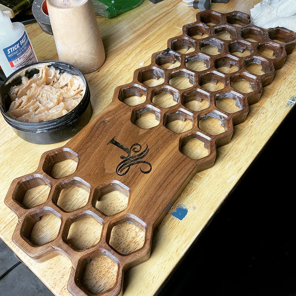

Then I sanded the whole thing to 220 grit. This is also the point I took the trivet to my laser and added the monogram. This could have been done on the X-Carve with a V-bit if I turned the piece over, but I wanted to play with my toys.

I sealed mine in CA glue and sanded forever. Then, using Yorkshire grit, I polished out all of the micro scratches.
