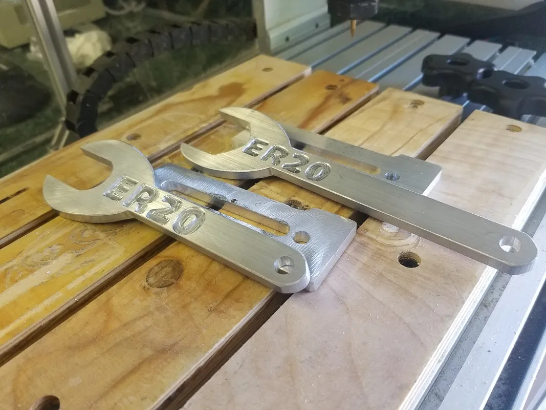

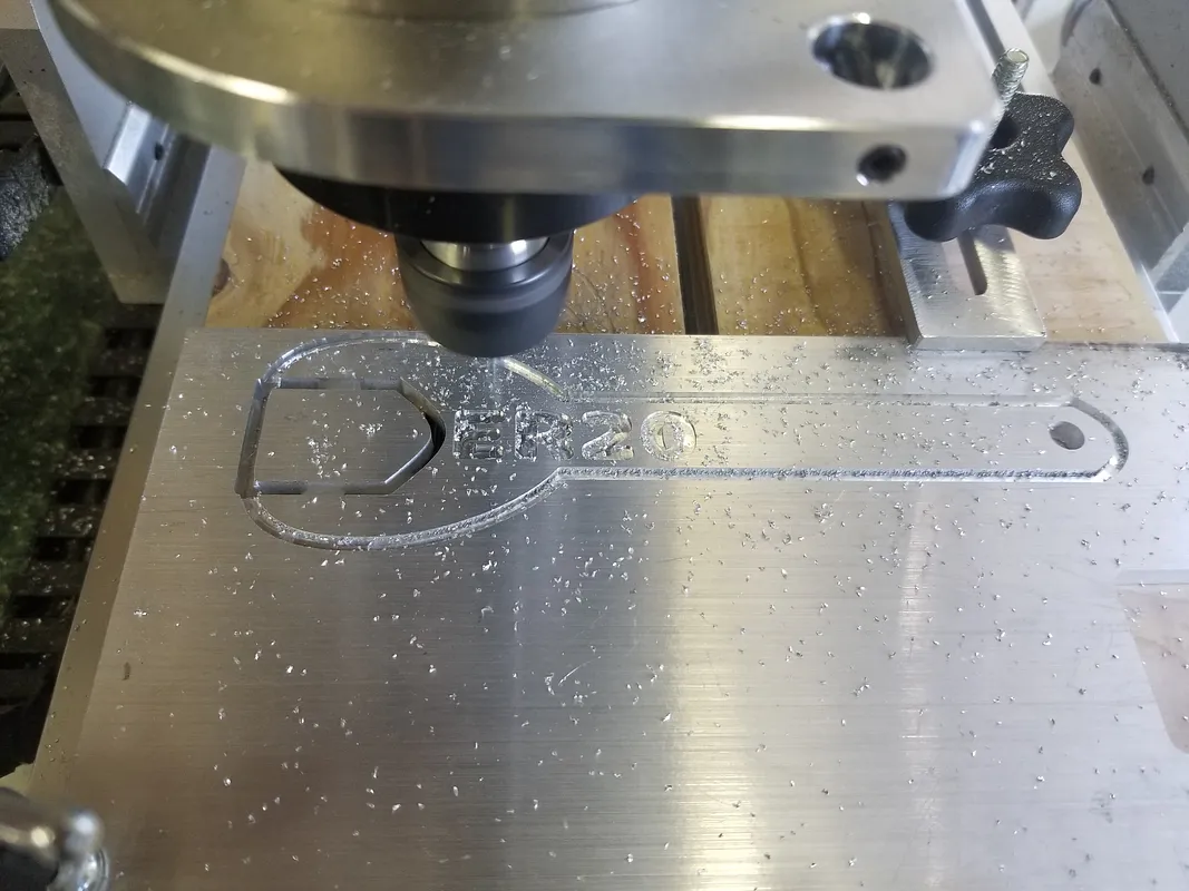

Here is a Wrench set that i made up real quick for my mill. i was tired of using my heavy PROTO wrenched si i made these out of 1/4" Aluminum.
i used a Amana 1/8" upcut single flute bit.

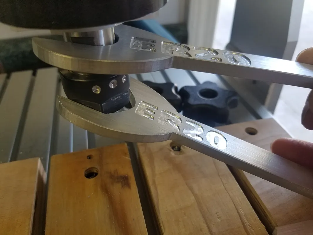

30mm for one and 21.5 for the other. great fit!
