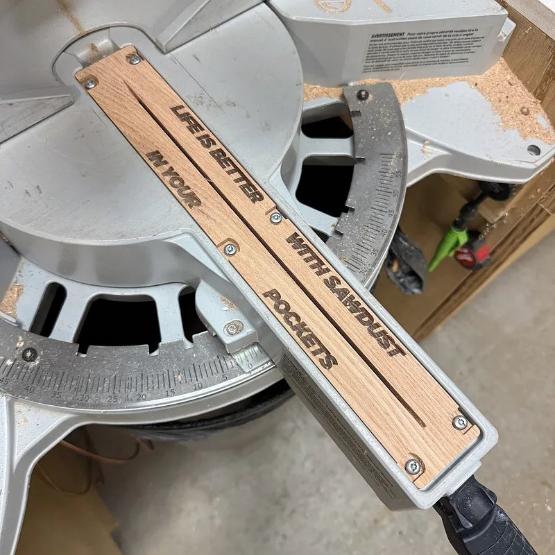

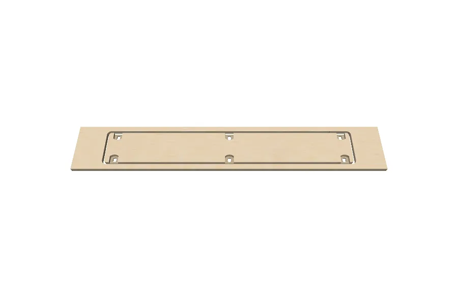

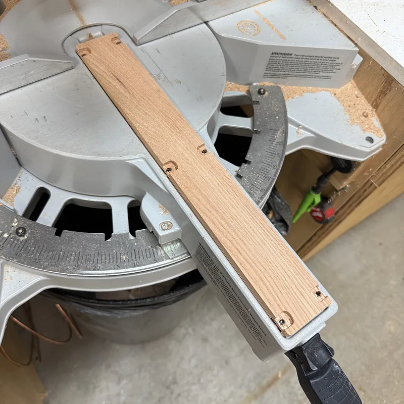

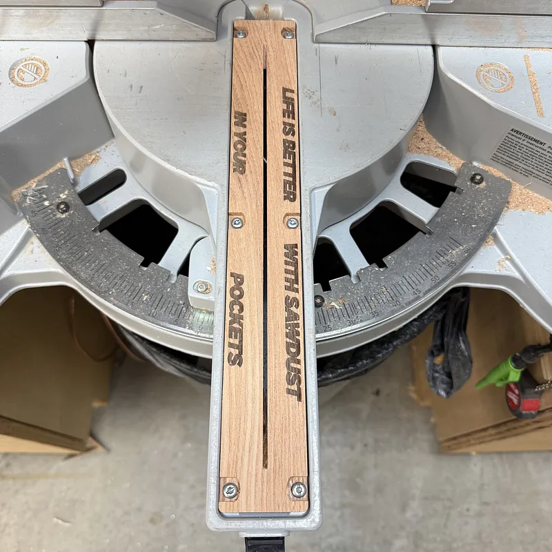

I use a cheap 1/8" compression bit for these and they come out nicely. The only thing to double check is that that outer rectangle is set to cut outside the shape in your Easel setting.
