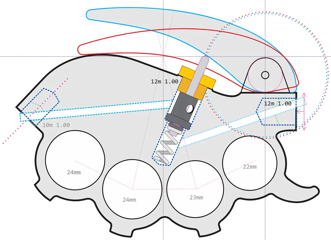

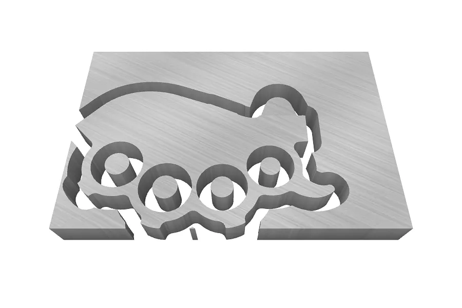

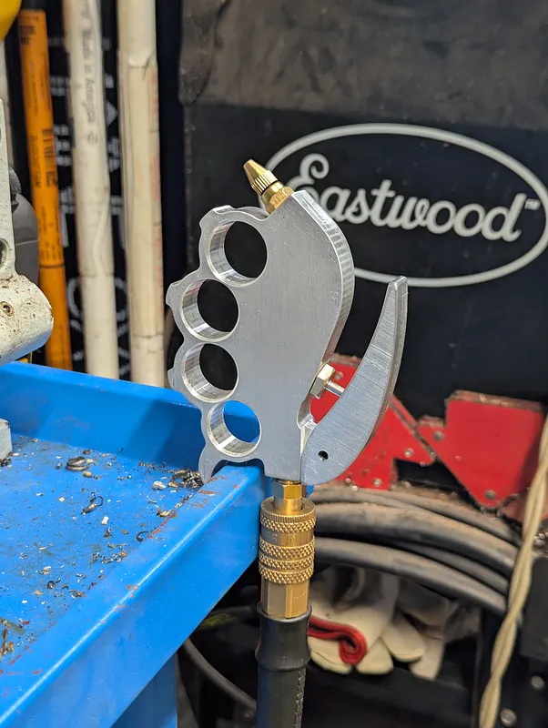

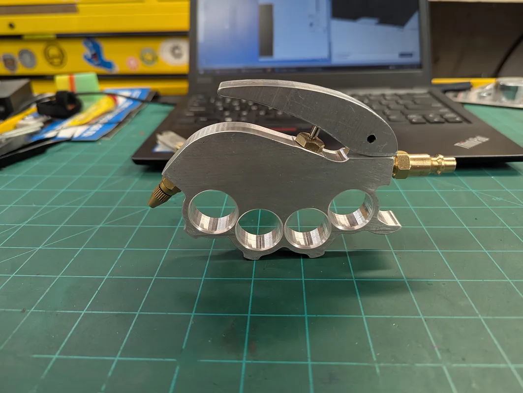

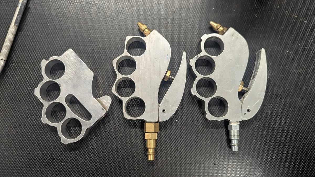

I had a miserable time trying to make this on a foxalien 4040, but now that I have a prolight 1000 cnc mill, I was able to carve one out of 5/8" aluminum with a 2 flute 1/4" end mill in about 30 minutes or so.
Some extra machining needs to be made for the handle pivot and of course all the valving and air passageways.
