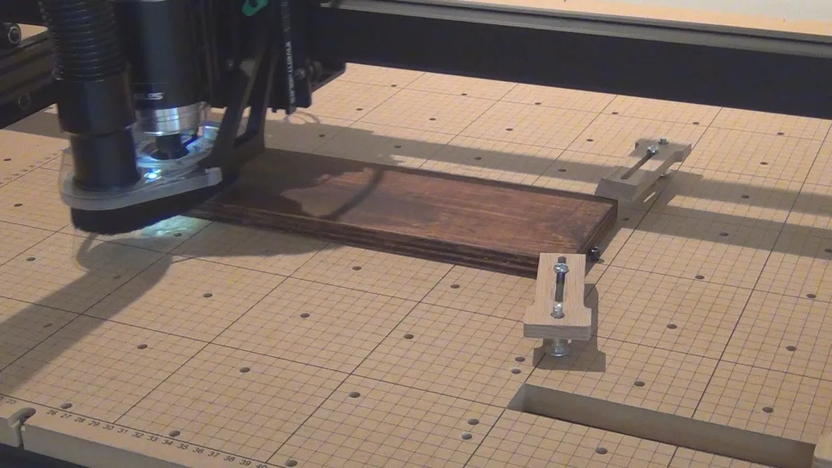

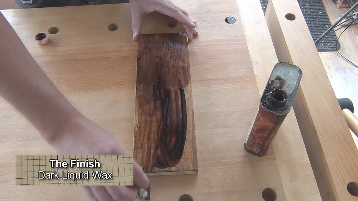

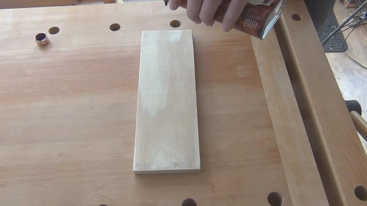

Cut the storage board blank out 13"x4½", from a 5/8" or 3/4" thick piece of plywood Apply a finish to the board, such as a colored wax (as I used), shellac, or paint, and allow to dry Secure on the machine

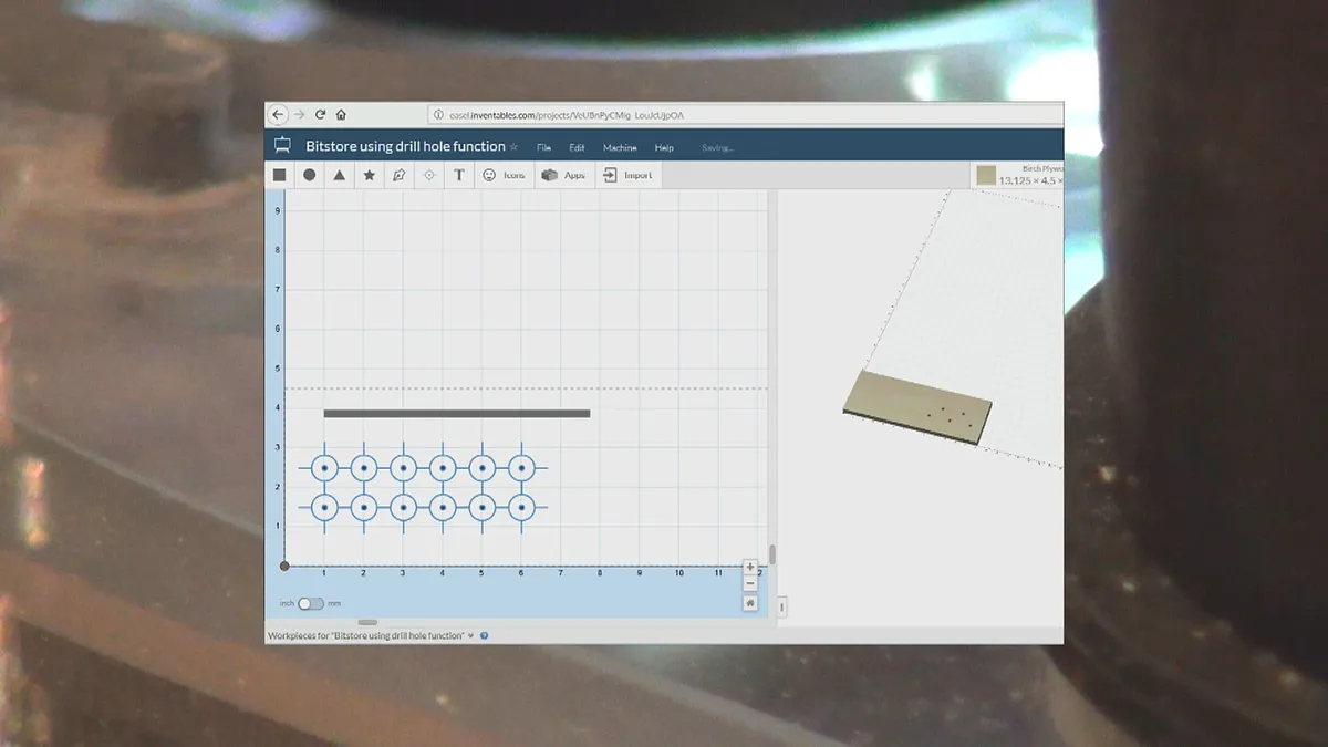

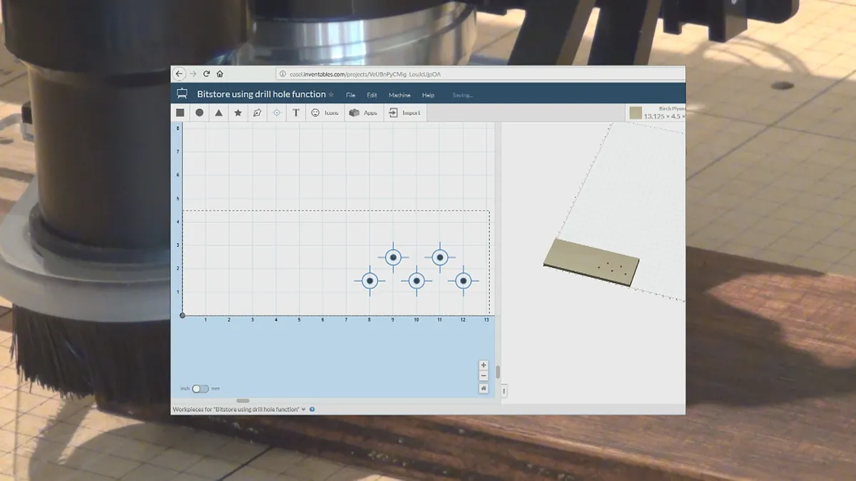

Cut 1/8" Holes on Machine
Select the first 'workpiece' in Easel, and carve it with the 1/8" straight bit
Estimated time: 10 minutes

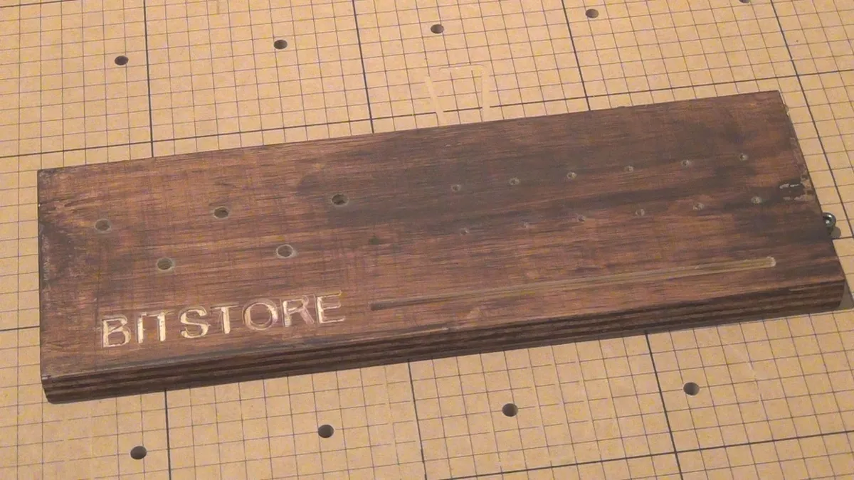

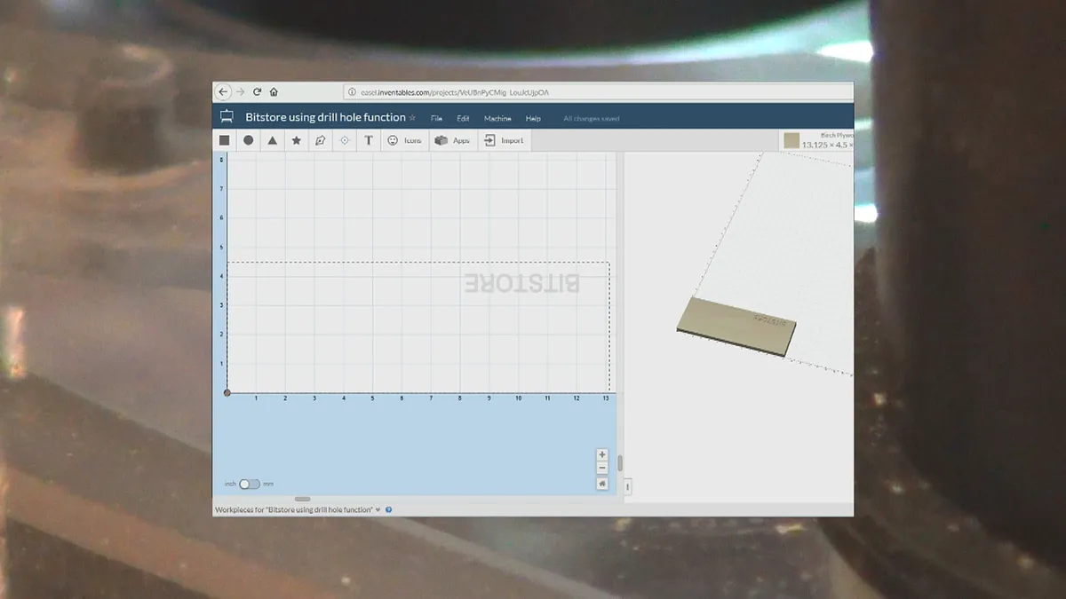

Cut Text on Machine
Select the third 'workpiece' in Easel, and carve it with the 1/16" downcut bit Of course you may alter the name, BITSTORE, to anything you wish
Estimated time: 2 minutes
Cut 1/4" Holes on Machine
Select the second 'workpiece' in Easel, and carve it with the 1/4" straight bit

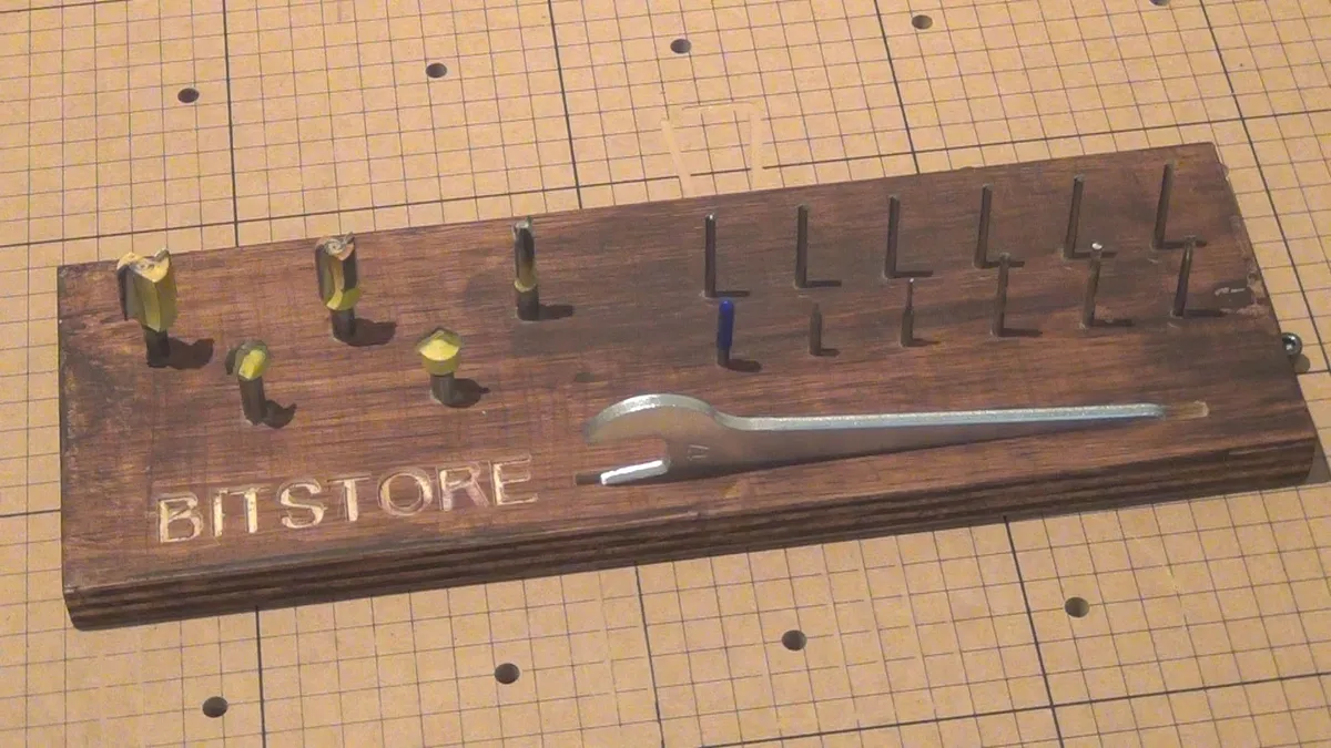

Tidy Up and Use
Lightly sand any frayed edges from the carve Insert your most used selection of cutters, and the collet wrench
