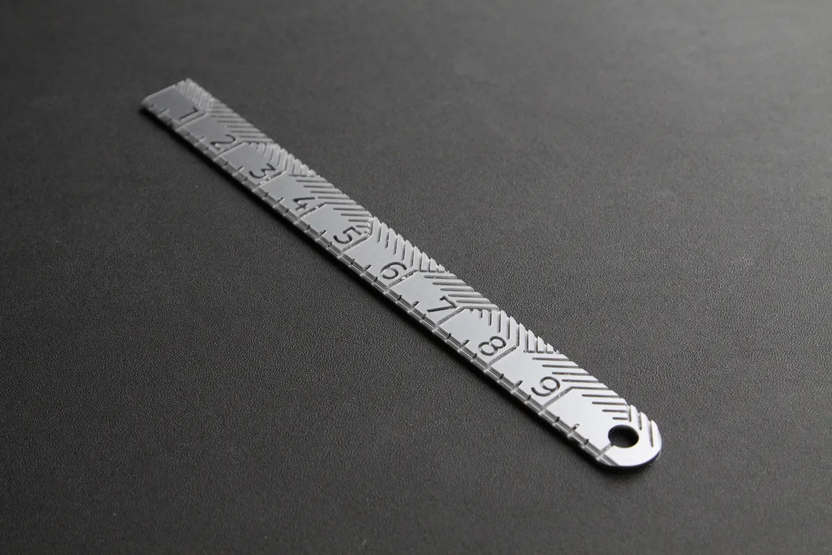

Change the font. Create a pattern or add text to the top area. Add an icon from the Easel library. The ruler spacing and outline is ready to go, the rest is up to you!
Use this EASEL "link":http://easel.inventables.com/projects/7yD7kHjdVS_TN8vK06Ee0Q
2

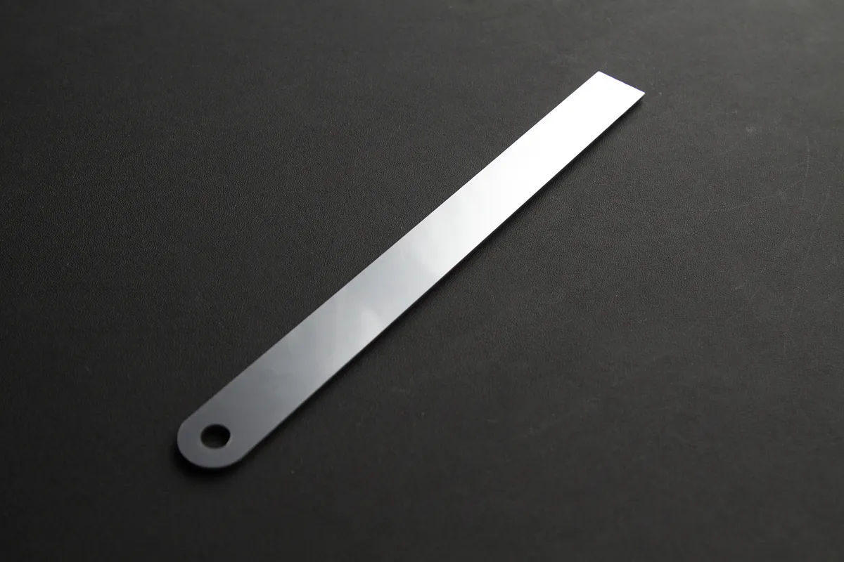

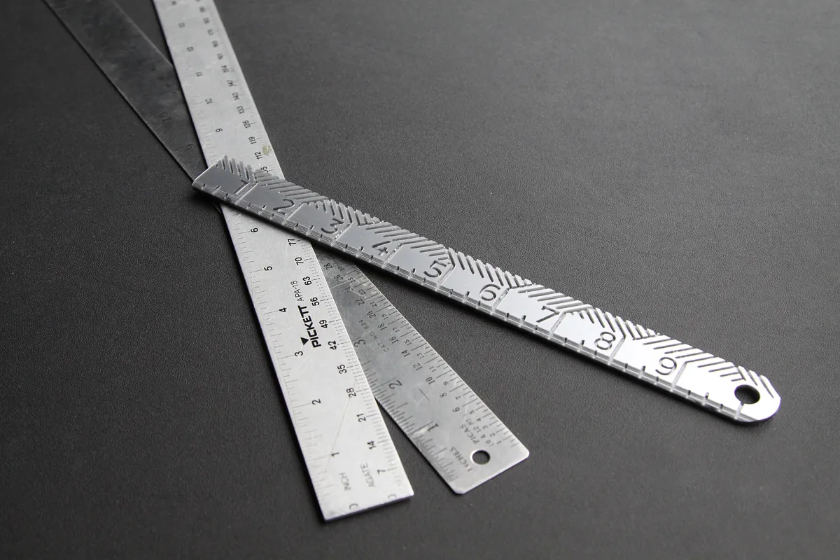

Cut the part
Mill the design from 1/8" material of your choice. We used gun metal acrylic and it looks great. A small bit is necessary for getting the fine linework. 1/32" should do it.
