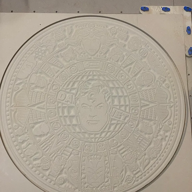

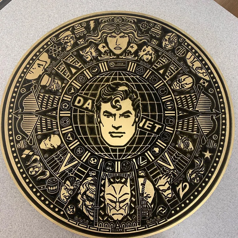

DC comic version of the Mayan Calendar made from MDF Carved in three stages, first being the center at around two hours with a 90 degree V-carve bit, the second portion being around five to seven hours with the same bit, and the last carve is the cut out which is switched to a 1/4 in down cut bit.
x-carve 2016
MDF
