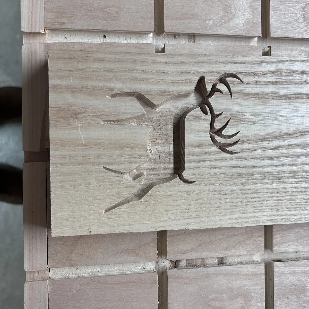

You can see some chip out in a few places on the plug in your pre glue up shots. I wonder if a new v-bit or less aggressive settings could get better results on those antlers.

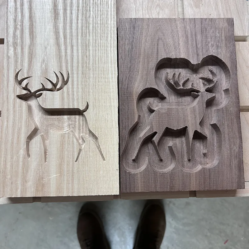

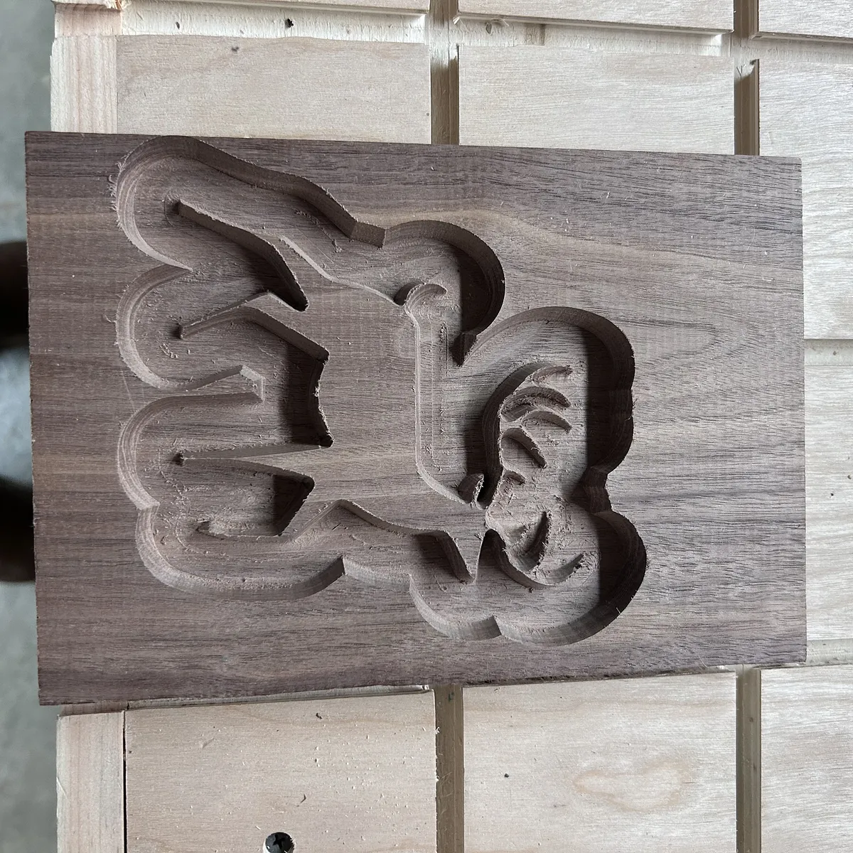

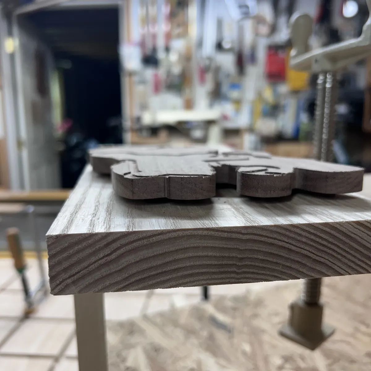

Here's the finished cut! Not sure if the antlers will come out they are awfully thin. Just finished gluing and in a press results tomorrow.
Sam DauriaPro · June 12, 2026
8mm seems awfully deep for an inlay. Is there a reason you need it to be so deep?
John McWhirterPro · June 12, 2026
John I’m just experimenting

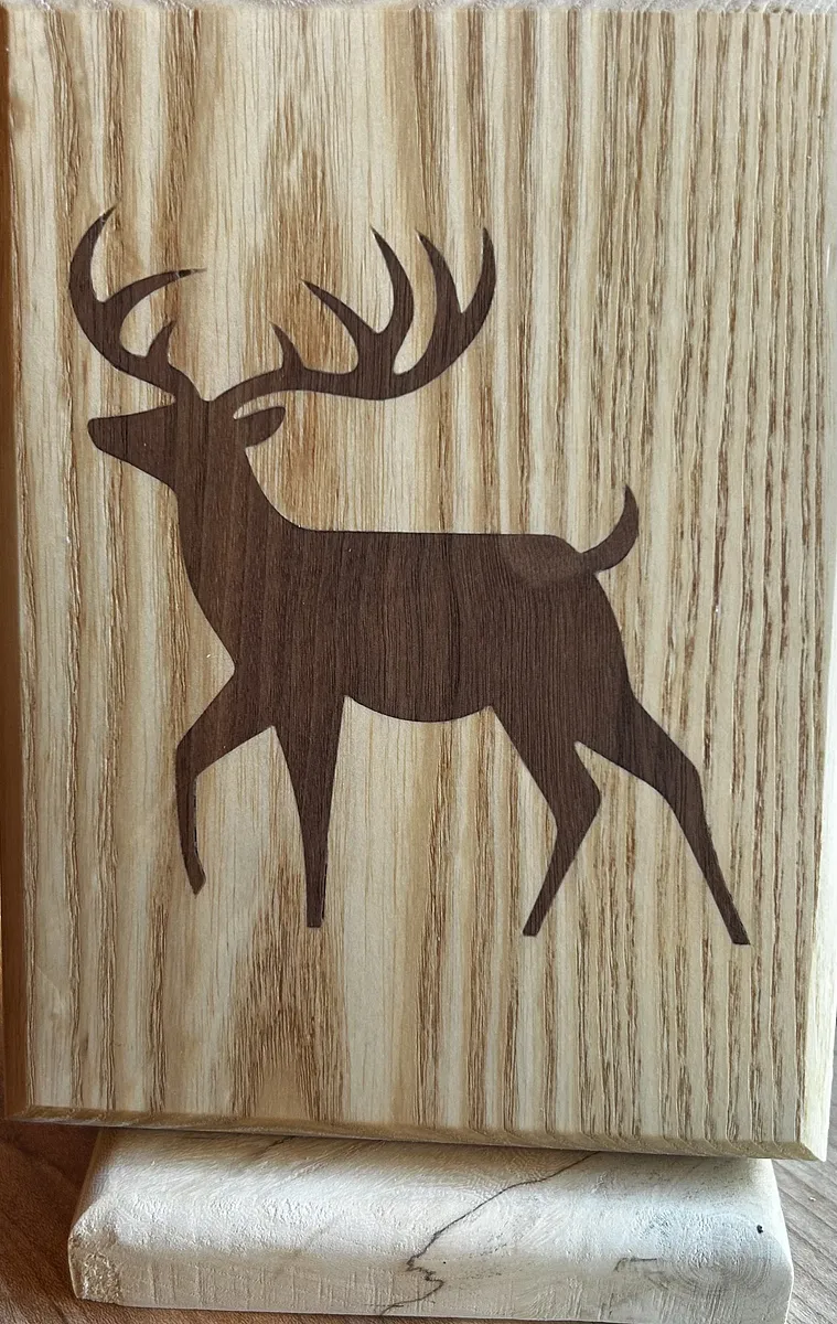

Here is the deer finished. Not too bad, at the very tip of the left antler a minute gap
Sam DauriaPro · June 13, 2026
Here is the picture
Nice job Sam that looks great
Zach KaplanPro · June 13, 2026
Brian AdlePro · June 15, 2026
