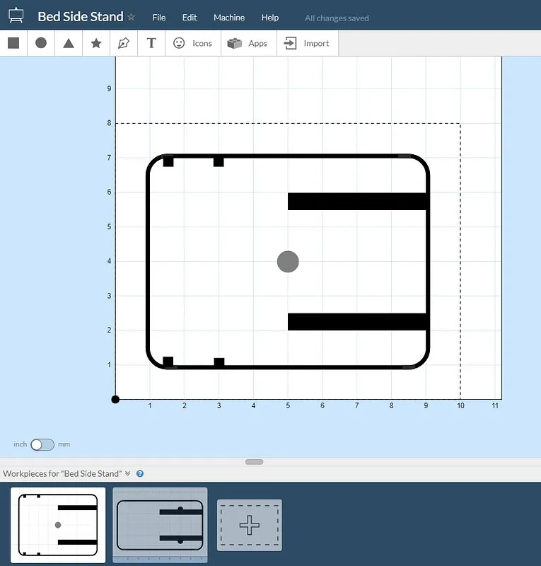

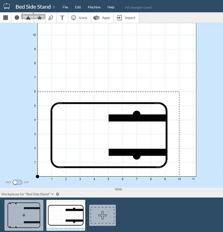

Load the Easel file and place your first board. The first cut will take approximately 26 minutes. Once finished, place your second board and go to the second cut page. This cut will take approximately 25 minutes for a total cut time of 51 minutes.
Estimated time: 51 minutes
