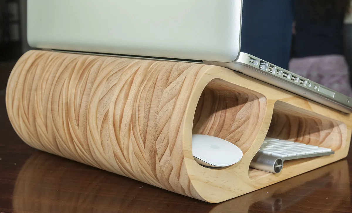

For the full details on the build you can go to this link and watch the video
http://www.onewood.com.au/how-to-make-a-wooden-laptop-stand/
The video shows a router table and scroll saw been used, you can now open the plan in Easel.com and make it with your X-Carve instead.
Just set the material thickness in easel.com, i recommend using 3/4" or 19mm material.

That is a very beautiful design. Congratulations on your creativity.

how many pieces you cut firthisproject //?
Michel Guerrero · August 19, 2015
Hi Michel i used about 12 pieces but it will depend on the thickness of the wood and size of the laptop.

Awesome design. Carved all the pieces and then glued them together to make the stand. Figure I would explain it to the ones who didn't get it.

To cut 12 pieces at 1200mm/min and 1mm DOC will take close to 12 hours. Using 19mm stock.
David Peterson · October 21, 2019
One thing I did was add 3 holes for alignment dowels and carved with a 1/4 inch bit .Then i speed up the machine to carve 2 out of a piece i can get 2 pieces in about 30 minutes
Jeff Richmond · December 05, 2019
i really like your design i found that the time it takes is undeniably overwhelming, I have modified the design to 12 minutes with an 1/8 inch downcut bit running at 30 ipm. also adding the dowel holes for alignment while gluing

I really like the wood that you used for this project. What kind of wood is it?
