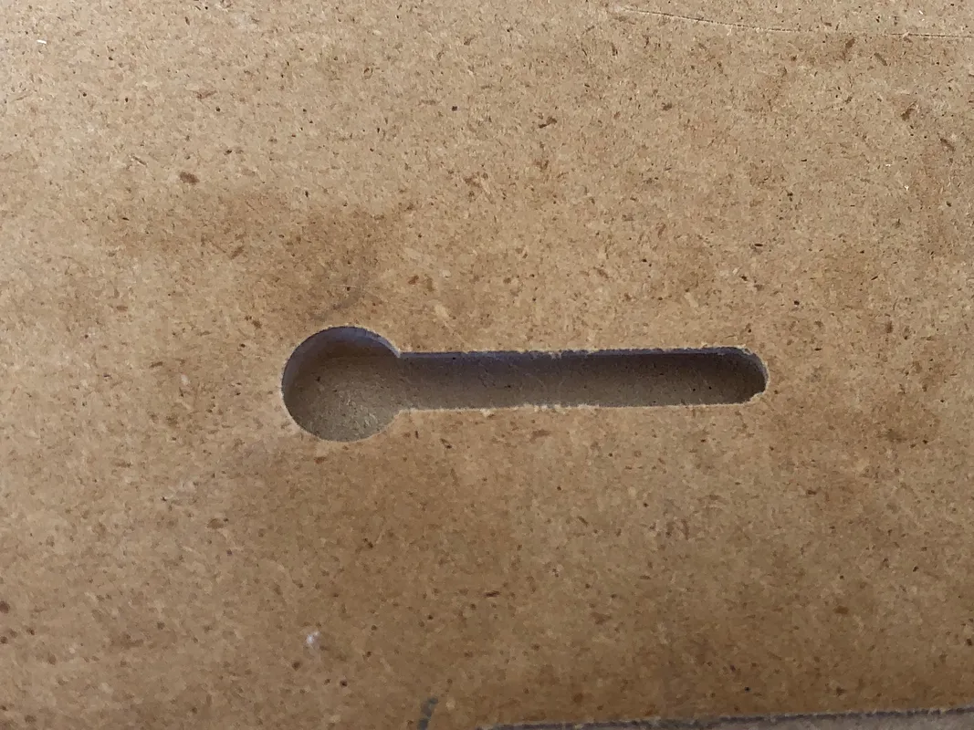

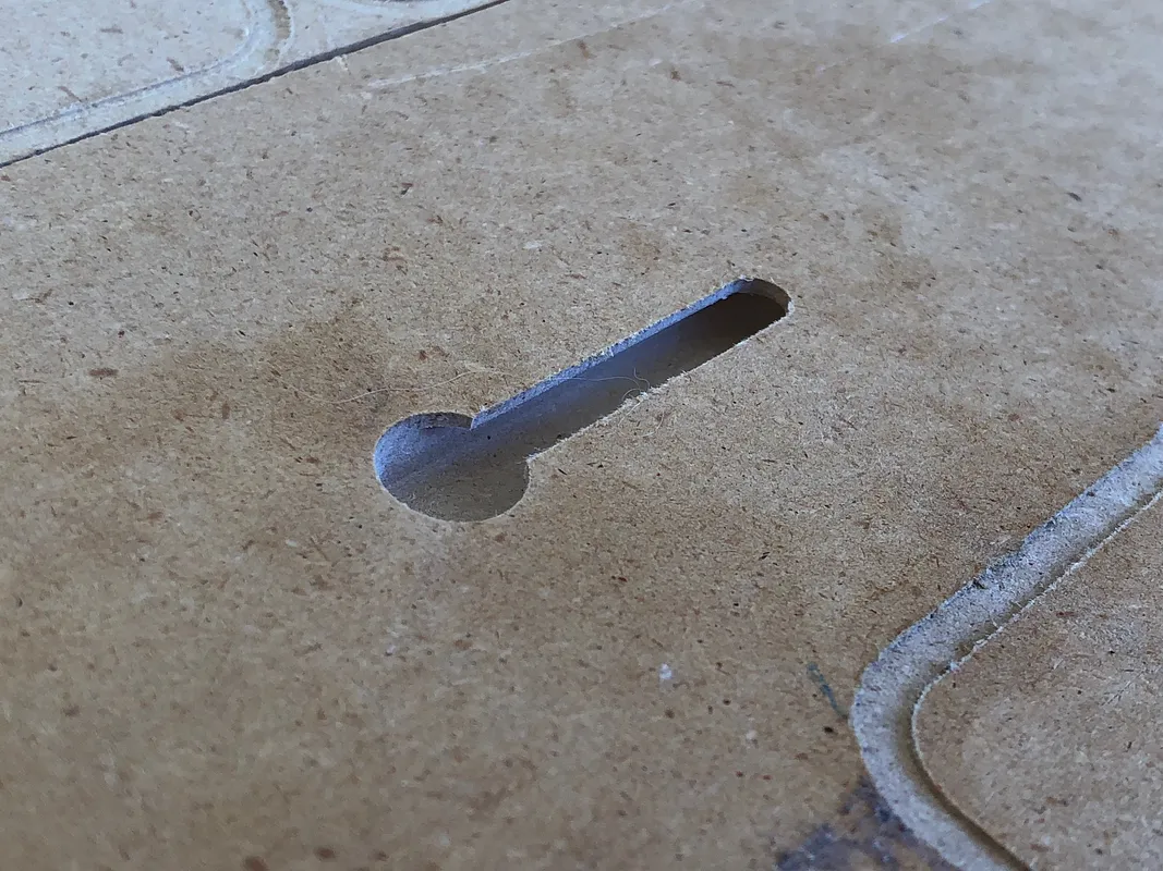

Making the Hole
Important!
-Easel does not properly show the material cut because it is an imported gcode file so it looks different in Easel.
-The hole will be centered 2 inches up from zero point so set your zero accordingly.
-The hole is 0.25" deep so ensure that your wood is thick enough so that the carved design on the back side is not so deep that the keyhole will poke through your carving.
-The hole is 0.25" deep, 1.5" long.

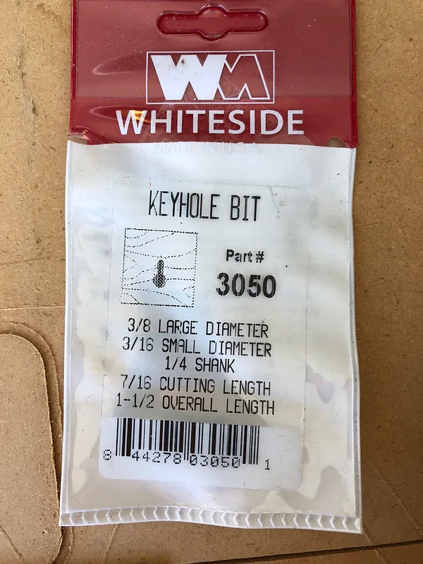

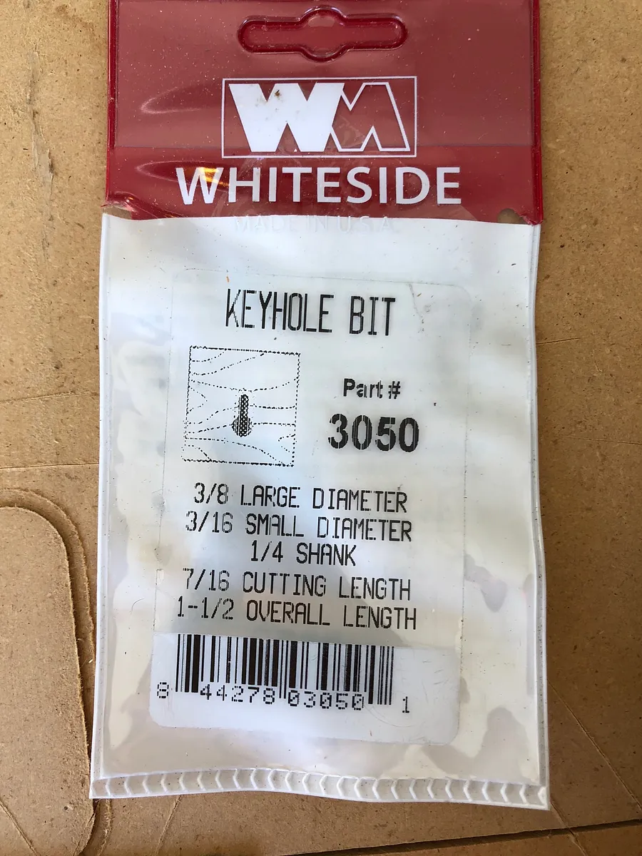

-This hole was designed for use with a keyhole bit of the following dimensions:
3/8" large diameter
3/16" small diameter
1/4" shank
7/16" cutting length
https://www.whitesiderouterbits.com/products/3050
Estimated time: 1 minutes
