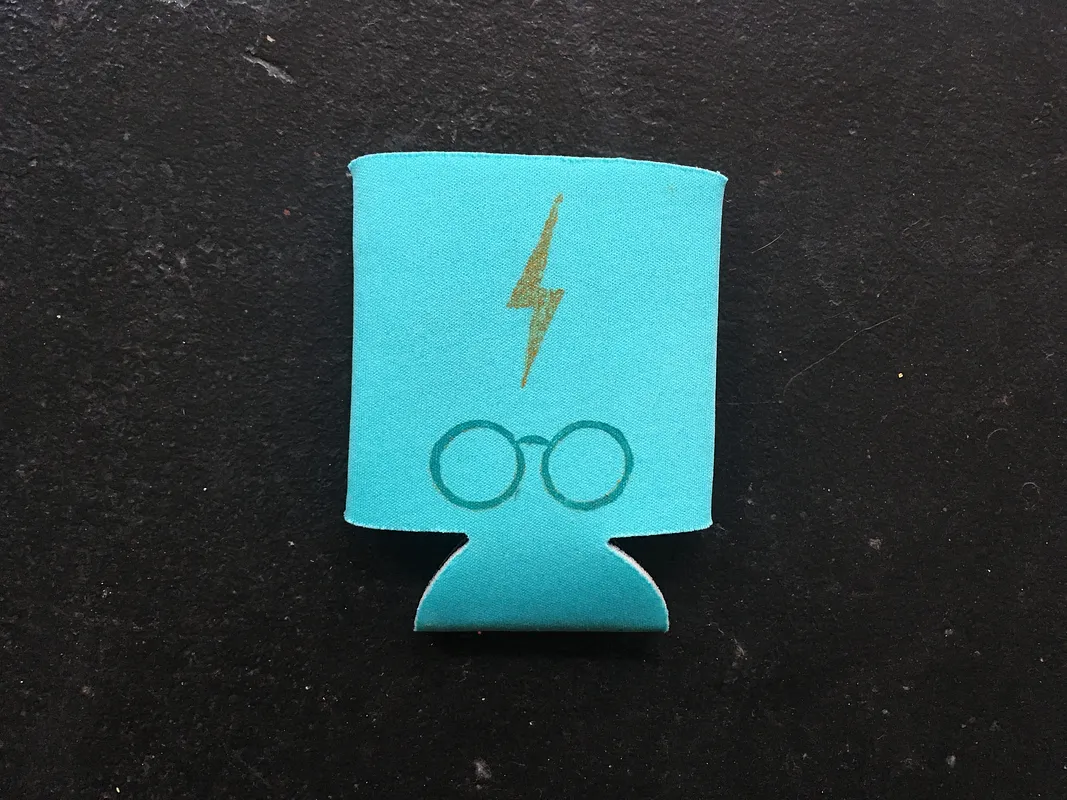

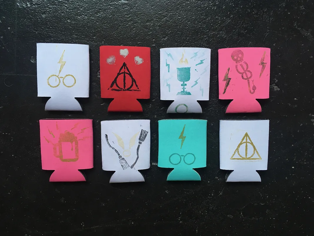

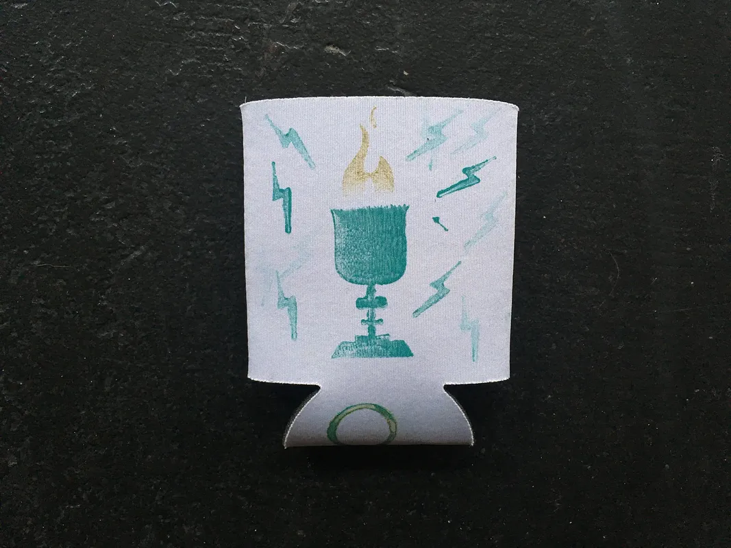

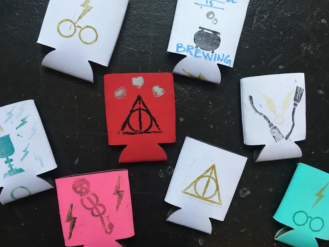

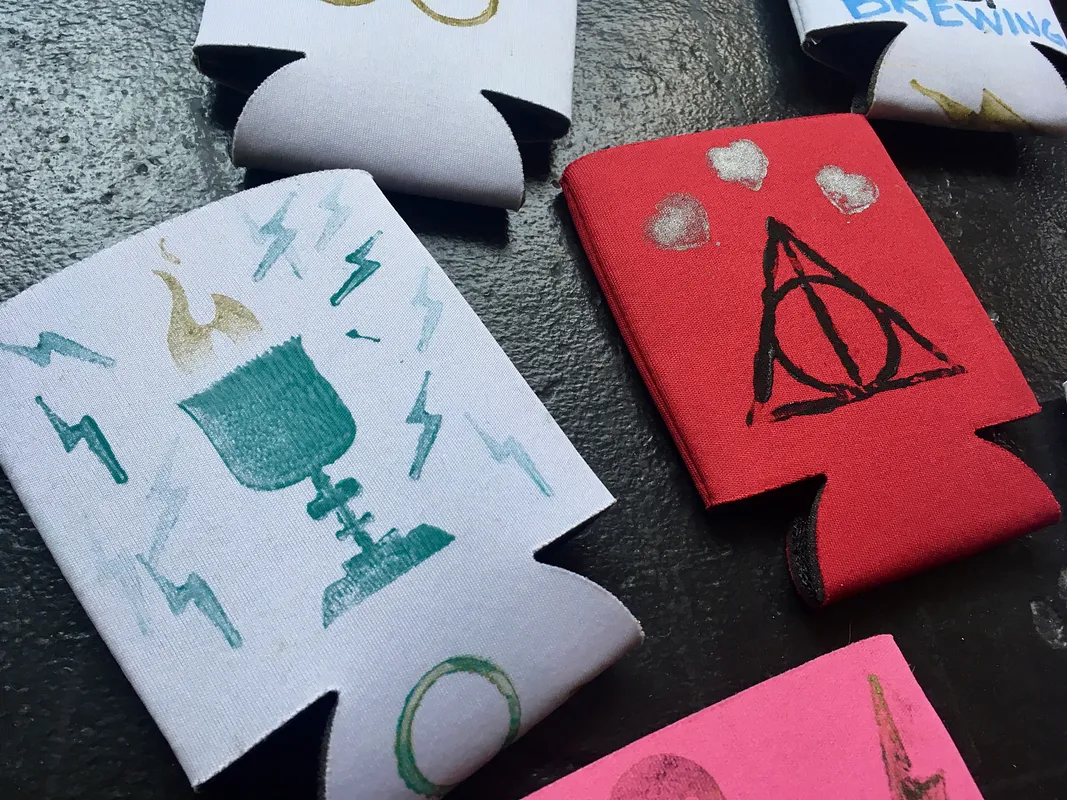

Stamp some magic!
Get out your favorite ink colors and start stamping! We used fabric ink for the koozies, but you can use any kind of ink for any type of projects.
