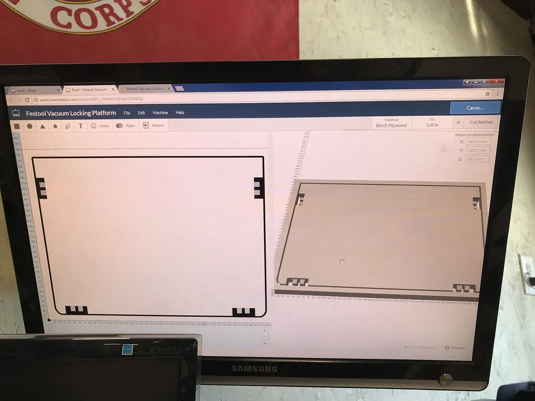

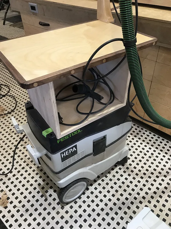

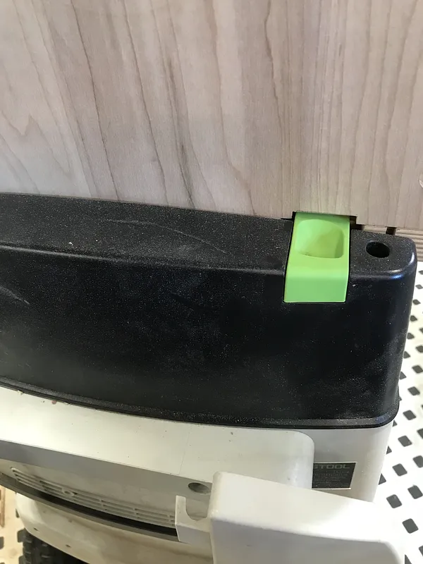

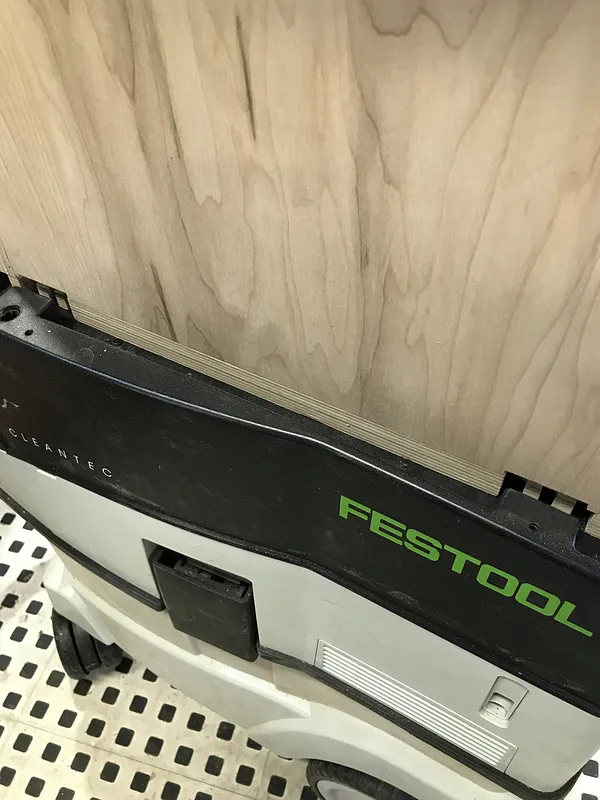

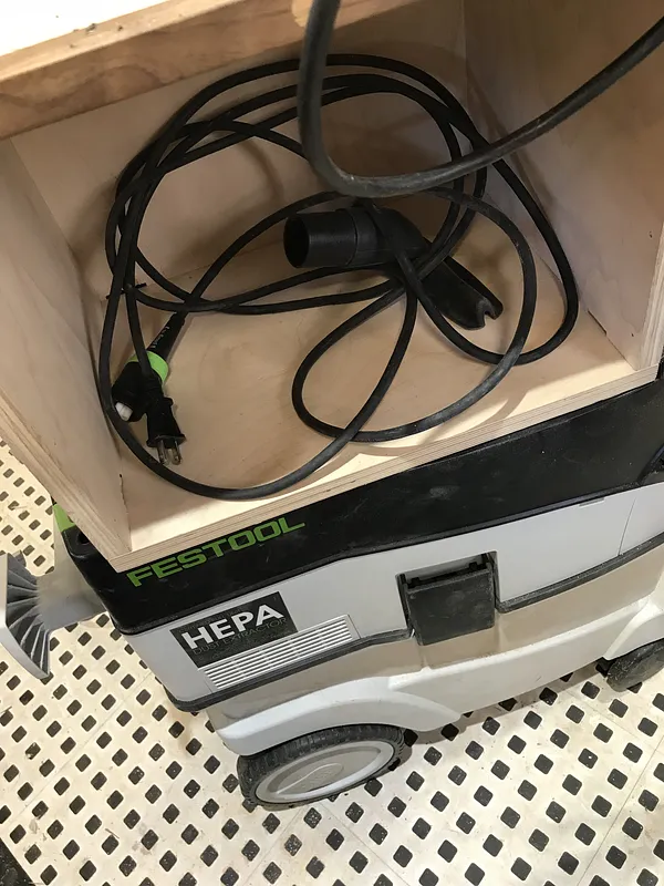

This will carve a platform that locks into your Festool Vacuum, works great as a table on top of it or as platform to be able to build off of. I used an 1/8" straight bit for the carve and a 3/4" piece of plywood.
