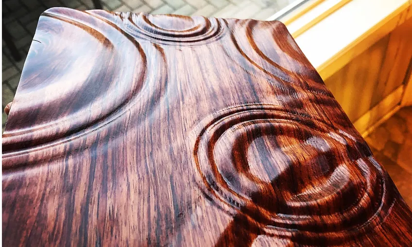

A fun serving tray and conversation piece. Bubinga Wood, Tung Oil, w/ Poly finish. Cut profile to whatever shape you desire.
Fusion 360 project = https://a360.co/2ZtqG2T
I attempted to make one with 1/8” up cut spiral but and had lots of tool marks. How did you get yours to come out so smooth?
Greg Ellenberg · August 25, 2019
I used a 1/8 "Ball Nose" bit and spent a fare amount of time sanding. I tried a "sanding mop" on a drill press but found that it could not reach the small areas in-between the ripples. Sanded a few finger nails down on those areas :) Good Luck!
Rick Ogg · August 25, 2019
Thanks, I am attempting to create one now. Any way to enlarge to 24" width?
Greg Ellenberg · August 26, 2019
I've added a link to the "General Information" section (above right) with the link to download the Fusion 360 file. You can download it in several formats and you should be able to adjust the scale to meet your needs. Good luck.
