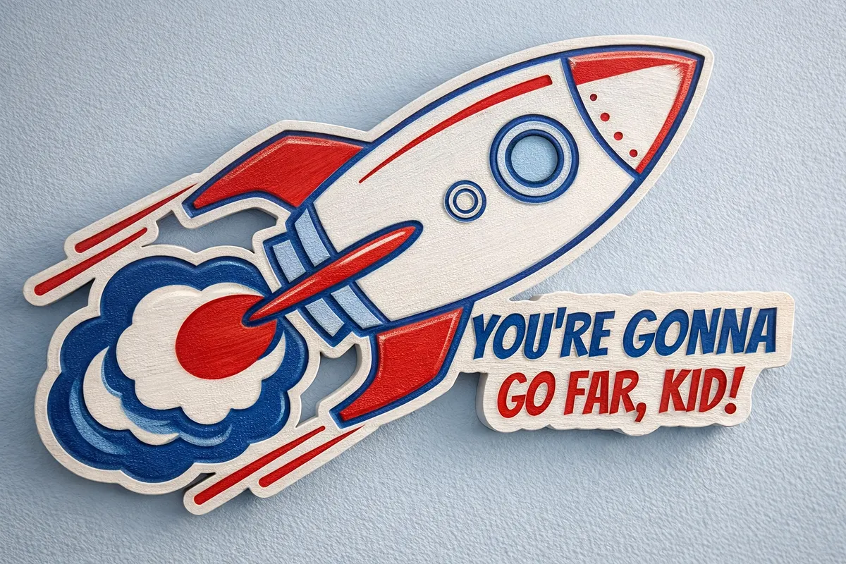

a whimsical sign concept for a children's bedroom or playroom. made using the new generate image feature for the rocketship. profile cut the outsides and engrave the shapes. i might opt for a 1/4" bit for the sake of speed. MDF so that the final product can be primed and painted smooth!
Lead CNC 1010
MDF
That looks incredible! Any tips for painting MDF?
Thomas L.Pro · January 27, 2026
automotive filler primer seems to be a big help. spray, don't brush. coat, dry, sand, coat, dry , sand, repeat. a smooth base will get you the best painted results.
