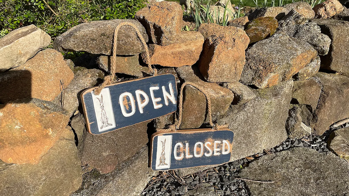

I first cut my boards to be 12 inchs in width, and then stained each side not including the edges. I used a Navy Blue Stain to cover both sides.
Estimated time: 30 minutes
CNC Carved Front and Back
I then used the project fileI created to carved both the front and back, being very careful to always place the spindle exactly at the same X and Y start point.
Estimated time: 42 minutes

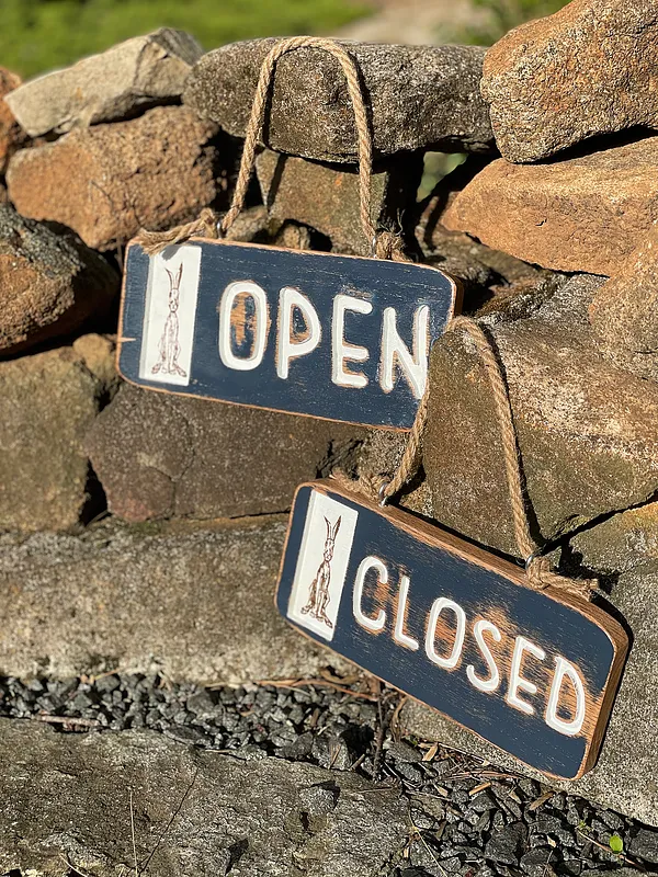

Painted
I acrylic backfilled the space for the logo and lettering on each side with Titanium white and back sanded if there was any overfill which will give it a rustic look. You can re-stain if you need to if you do not like that look. My client enjoyed the farm rustic look of it.

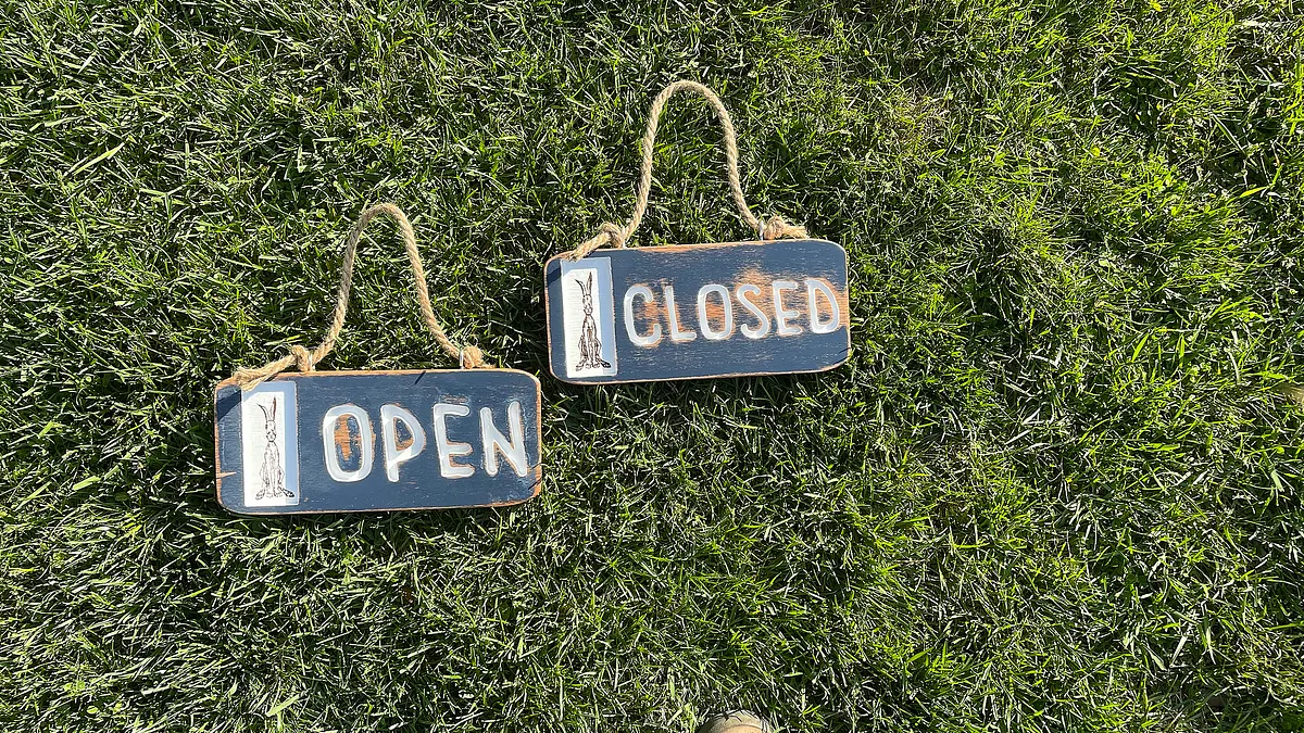

Lasered the Logo
I have a laser so I decided to do the Hare in the laser but you can obsiluly either remove the space for a logo or carve one in as well.
Lacquered and Equipment
I gave each side 3 layers of coating so that the client could use them inside or outside. Your preference of course. Then installed eyelets at top first using a drill to make wholes to ensure no splitting. added rope to hang.
