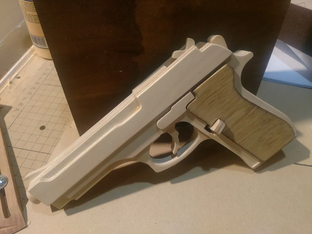

M9 Rubber band gun. Design is by RBguns.com and is offered as a free pdf download to be cut on a scroll saw. The nested parts were all redrawn in Corel then saved in Inkscape to svg. All the parts will fit on one sheet of plywood 1\8'' (0.125) 12in. x 24in. 0.125 Dowel rod. #16 rubber bands.

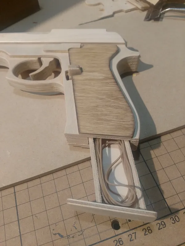

Hiya I love this gun! but I am kinda confused, how do you put it all together? and do you have some kind of instruction manual?
Elliot Garven · October 22, 2019

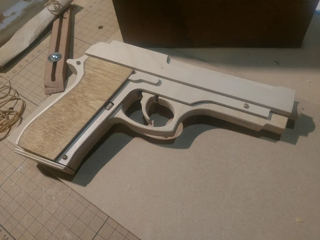

Elliot, all of the layers of one side and the middle sections are glued together. One opposite side and a grip layer are glued together and then those two layers are held on by a couple of small brass screws. I use Cp10 glue but regular glue is best to fit the parts precise. Hope that makes sense.
Nick Arnold · October 22, 2019
Install the moving parts in the pockets made by glueing up the layers together. Then they are held in place when you screw on the other side piece that has the other grip glued to it.
