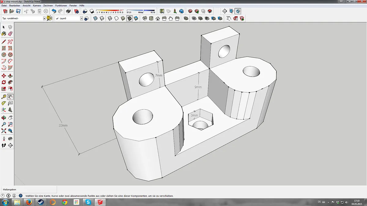

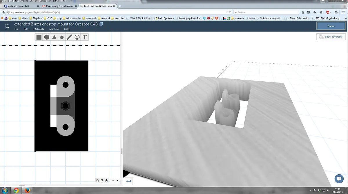

I don't own the x-carve machine. I have a 3D Printer and I'm very interest in all kind off this stuff. I tried out the Easel software to know what is possible with it. That's what I made: All software I uesed is free. -I drawed this workpiece in Sketchup. (Usually I would than 3D print it.) -I had to add a floor plain. -Exported a topview of it as pdf. (Perspective off) -Open the PDF in Inkscape and safe it as SVG -Import the SVG to EASEL -Set the depth for each plain like I draw it in Sketchup.
