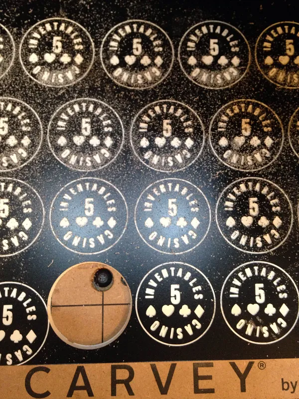

how do I cut the circles after the engraving
William Greenwald · April 05, 2016
how do I setup the machine to engrave the letters first and then cut the circles second is their two paths?
Easel now has 2 steps so you can cut with 2 different bits. Another option is to design the circles with the letters in one workpiece (at the bottom), duplicate it and on one erase the letters on the other the circles. Make sure you carve the letters first, then cut the circles.
Carlos Olvera · November 08, 2017
It would also be faster to use V-Carving instead of 1/32" bit to do the letters. I did a sheet at a time to make it faster.
Zach KaplanPro · November 08, 2017
I used the vacuum, them a tooth brush, and then washed them.
Zach KaplanPro · January 24, 2019
